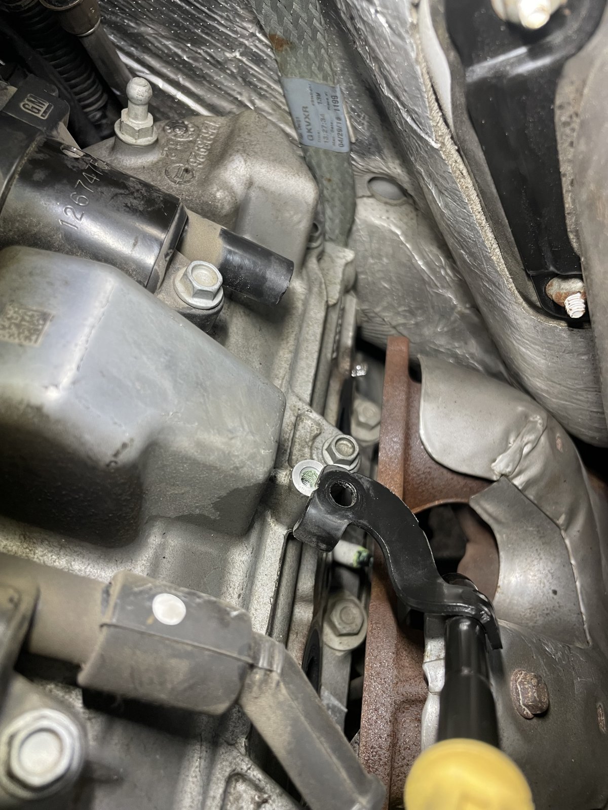

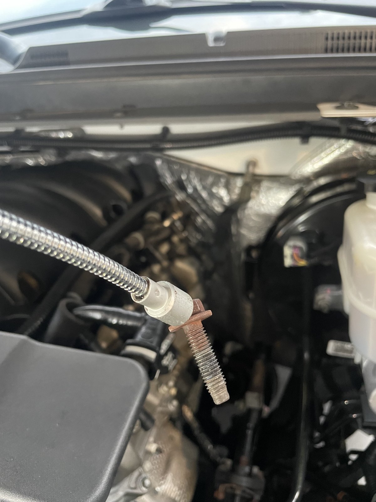

Besides welding a nut to it, anyone have a suggestions on how I could get the driver side rear bolt off?

First off, spray it down with some Kroil or PB Blaster if you haven't done so and let it sit a bit to soak into the threads.
Tack welding a nut would be the best way, not only to be able to get a wrench on it but the heat helps also.
You can try some heat if you have a propane or map gas torch, then clamp a pair of vice grips on it maybe?
Also, sometimes tightening it just a bit will also help break it free and allow it to screw out easier.

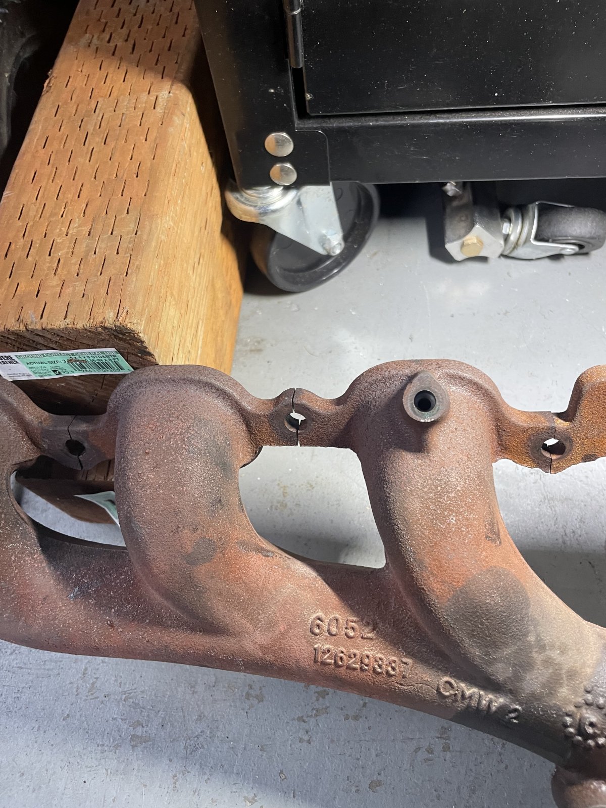

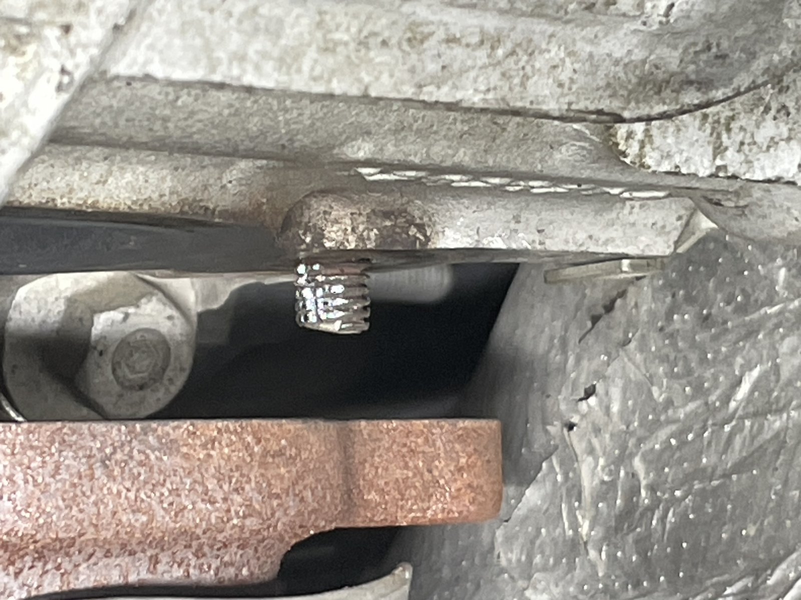

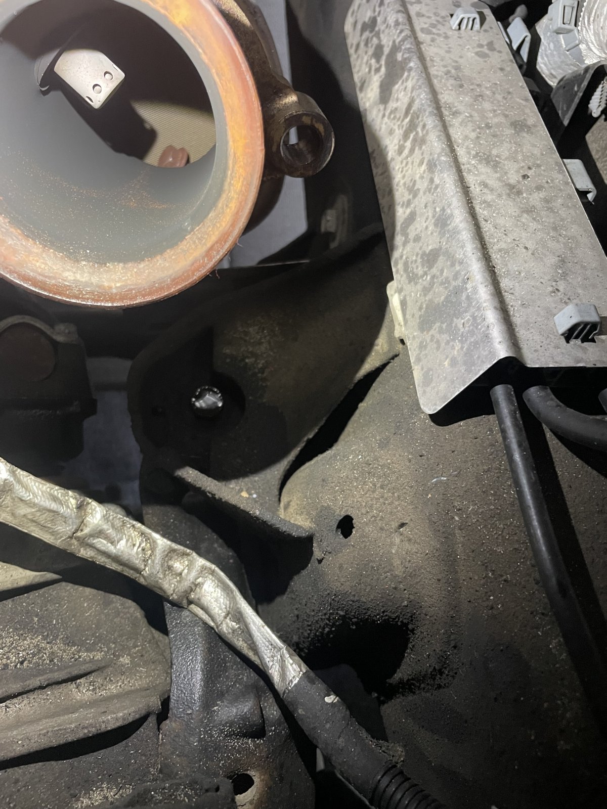

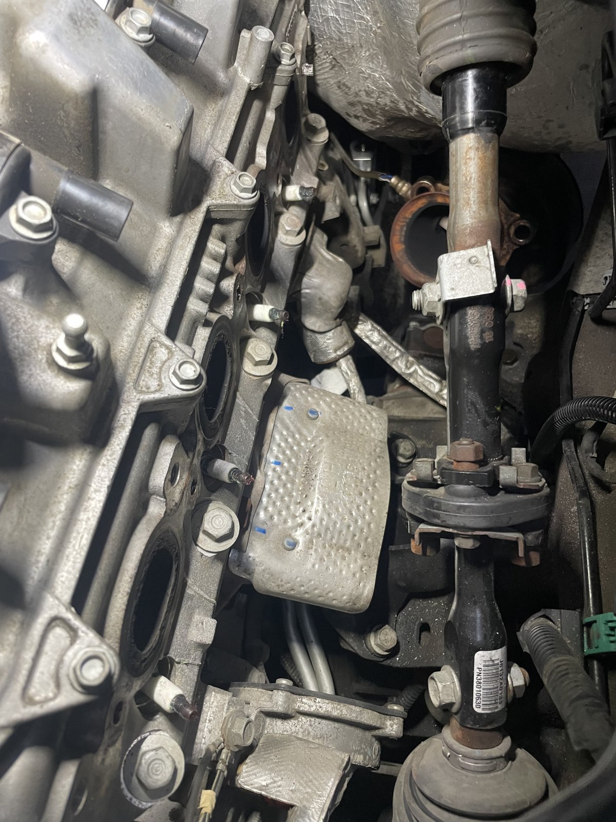

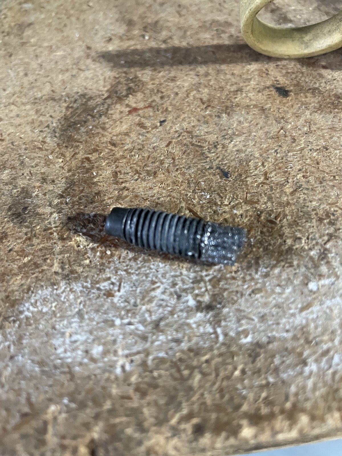

Well, I don’t get to try out the extractor tool, lol. After removing the manifold it gave me all the room needed to get a channel lock in there. Loosing and tightening it back and forth.

I traded an 07 Escalade for this 16 Suburban. Just starting to learn about this generation. I don’t recall with my Escalade, but are the cracks on the manifolds normal? It’s on the passenger side also. And before putting everything back together, are the engine mounts a common problem like in the 07-14 gen? Suburban has 128k.
That’s not a crack. It’s there by design to permit thermal expansion.
