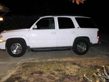

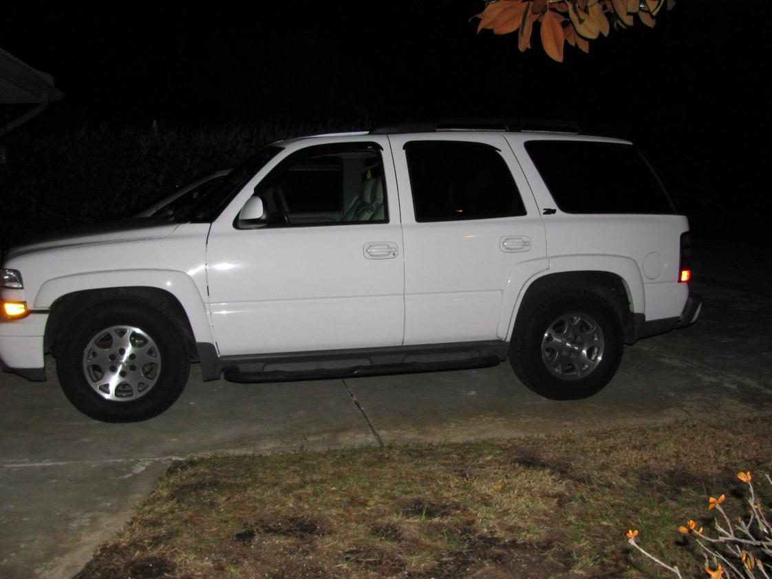

The lowering kit was on back order and did not get delivered until mid January. Finally had time and I installed the kit this weekend. At this time the front is a little to low compared to the back. Once the back settles I will adjust to get the look I want and then get the alignment done next weekend. I will post pics once it is complete.
The ride is very sporty but can be a little rough. I did install with my Z71 shocks since they are still good. I am wondering if I need to get different shocks.

The pic is not that good, need to take it before it gets dark.
Also adjusted the front, think I like it when it was a little lower.
