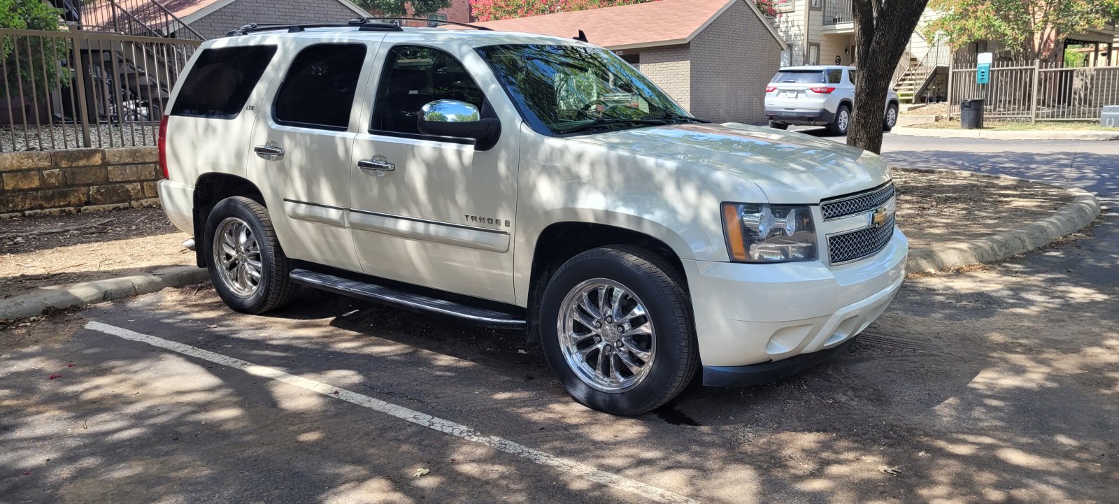

New to me 2008 tahoe ltz, 0 vin engine code, with 172k on the clock.
I've swapped injectors, coils, plugs, wires, and replaced injector connector.
Rough idle at cold start, runs smooth(er) when warm, but still not smooth. After a while it does produce a code for evap purge, I think it's a 0496 or something.
Compression test is good and no audible ticking.
What next before I abandon this 3 week old project?
