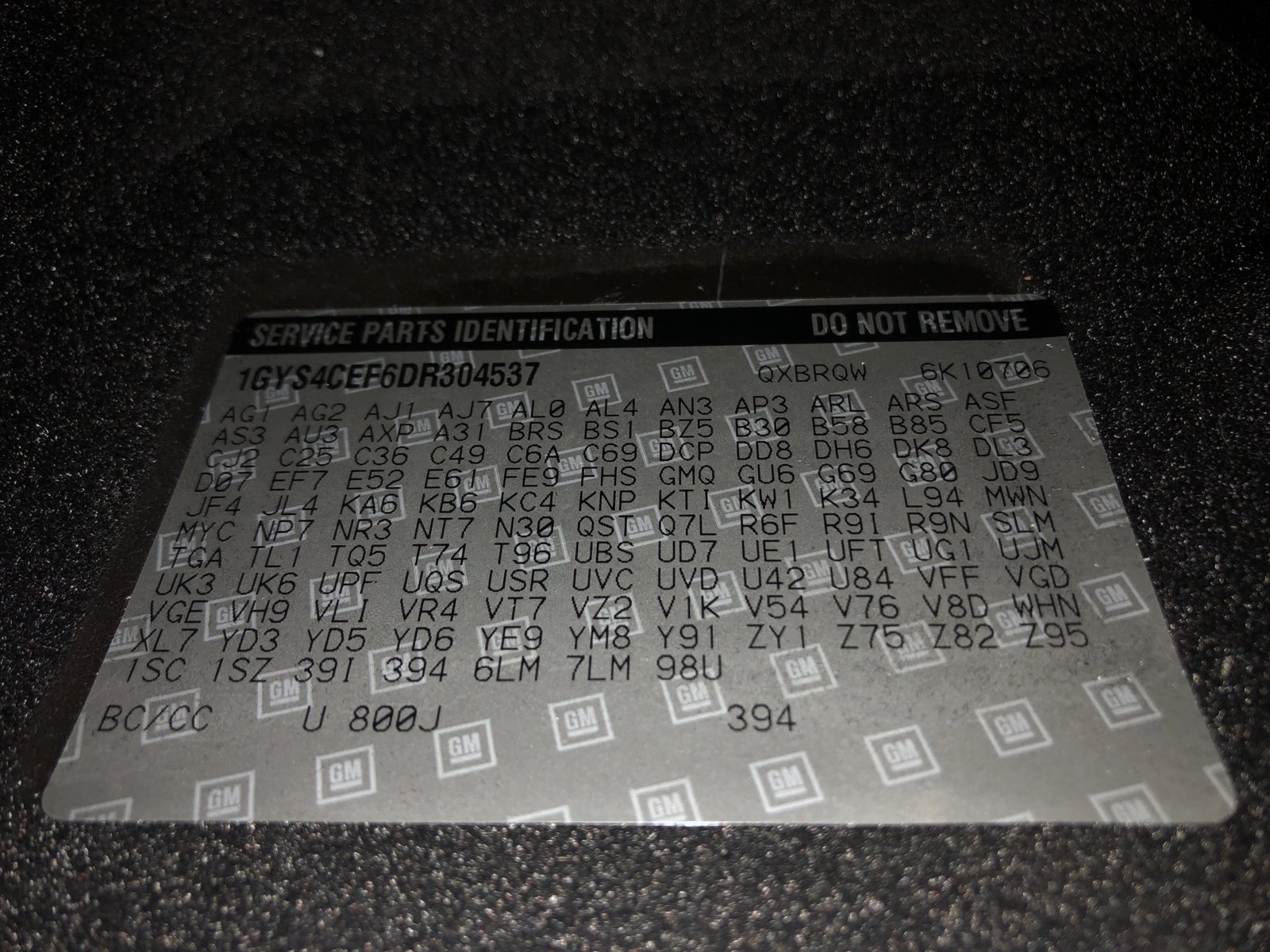

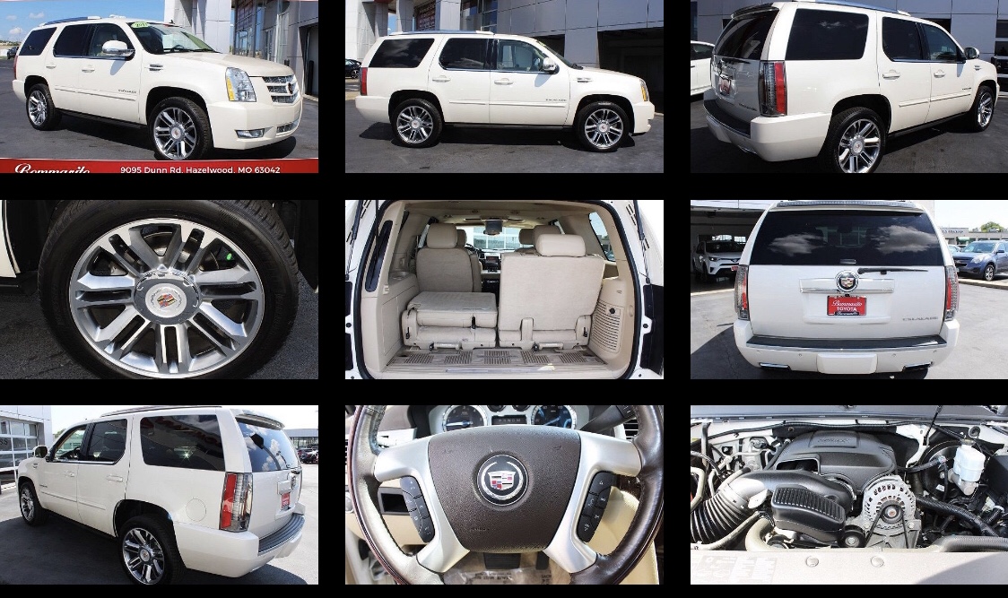

After much deliberation, and the guy selling the Yukon being a little too proud of the truck (and a little disingenuous about rust) we settled on the Escalade.
View attachment 210591 The Dadillac will be here soon...
Ps @HiHoeSilver I guess you’re gonna have to upgrade soon! ;)
Yeah, buddy! Stats/build sheet? NNBS Esky is definitely on my do want list.
