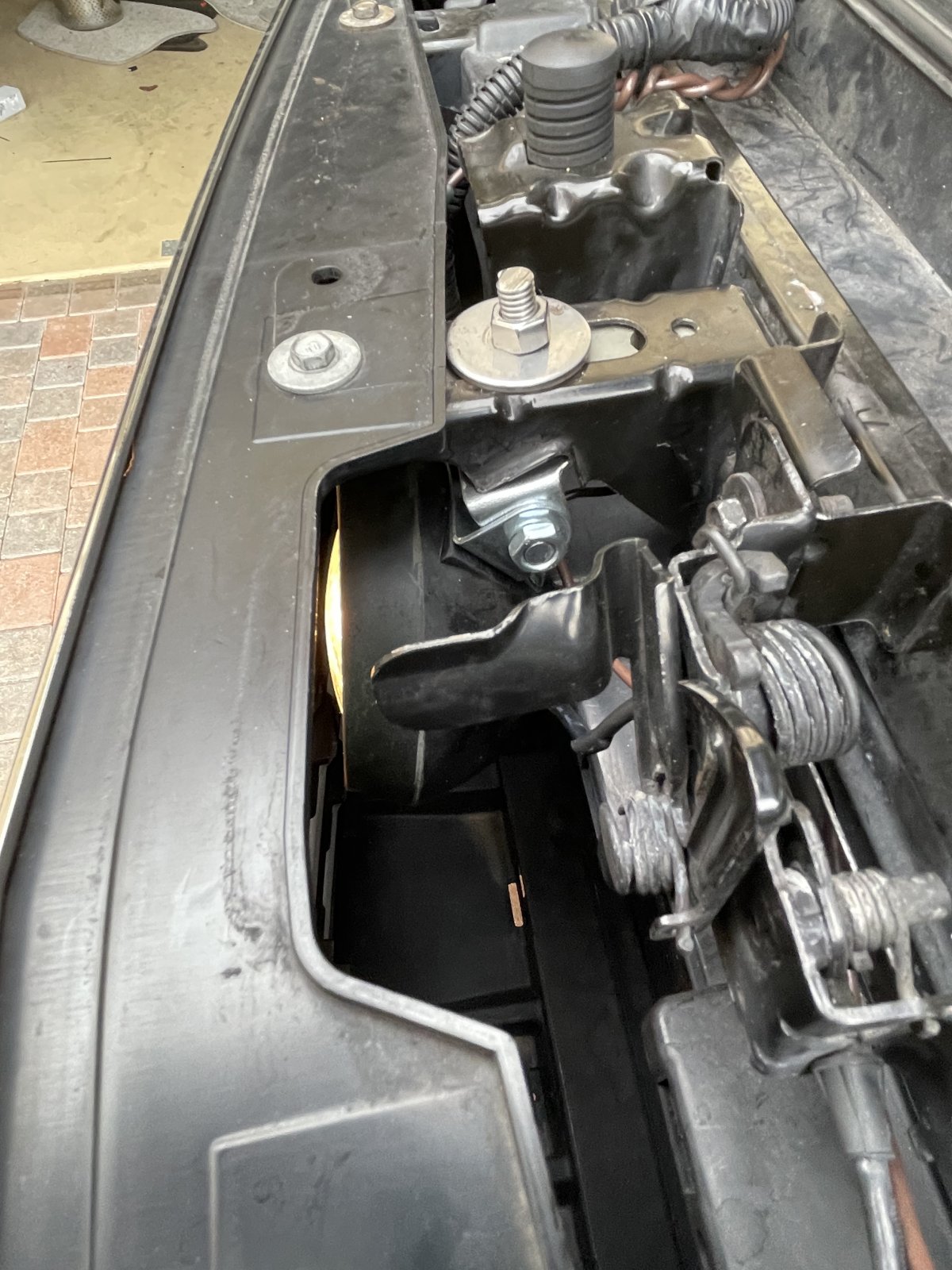

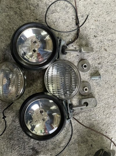

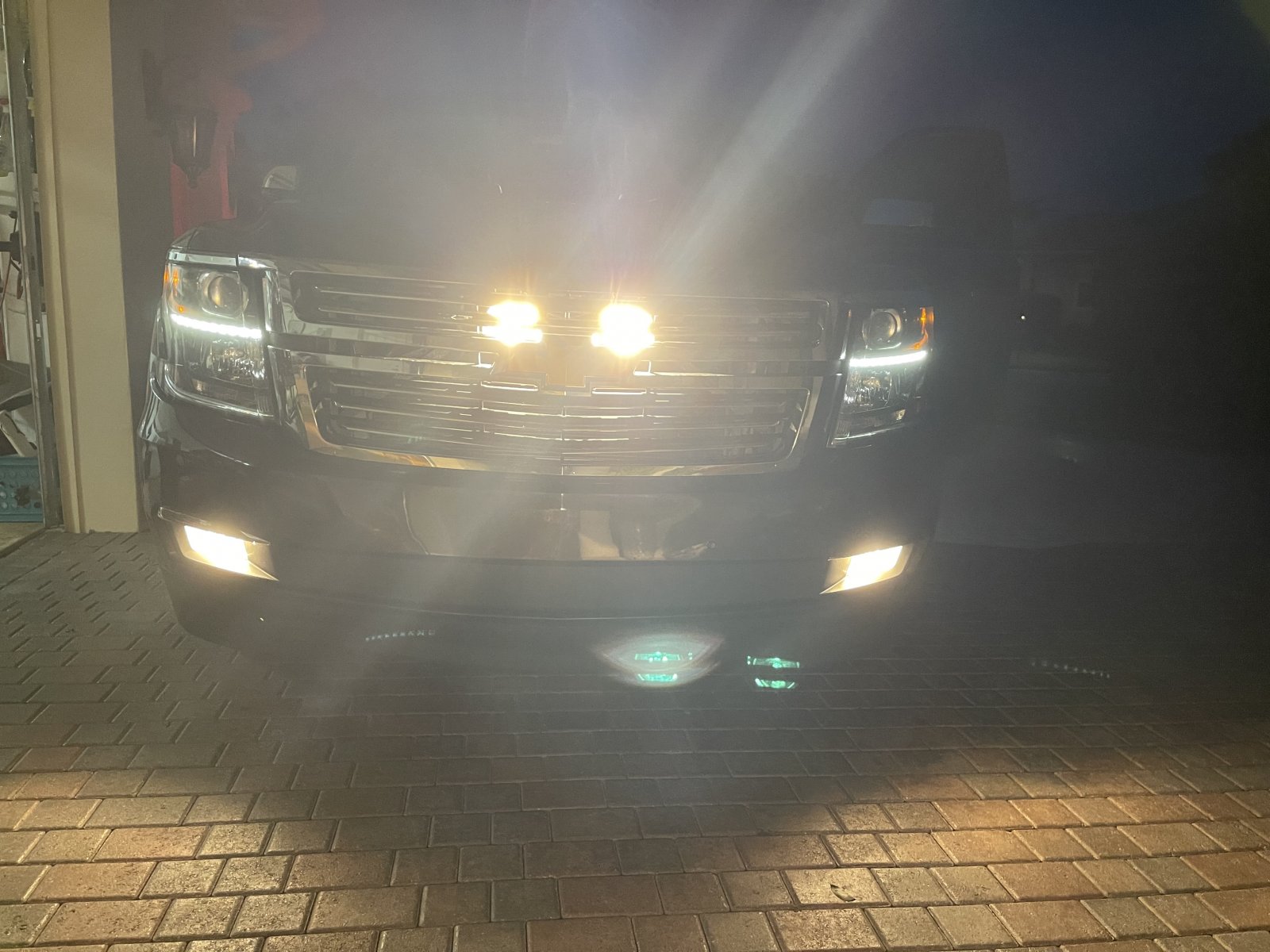

Home grown lights behind the grill altogether about $100, using 100 watt aircraft landing lights no holes drilled, activated off Fog Light switch
only need to remove hood latch Thats 2 bolts to install the lights
