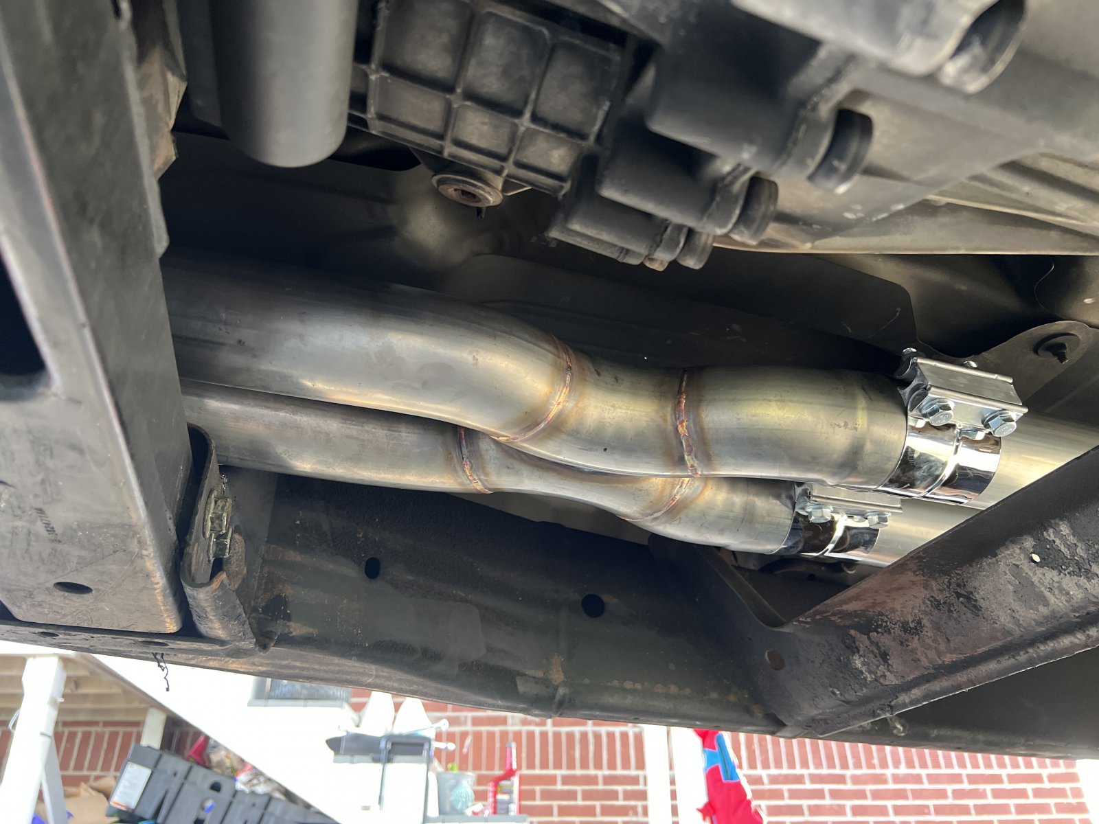

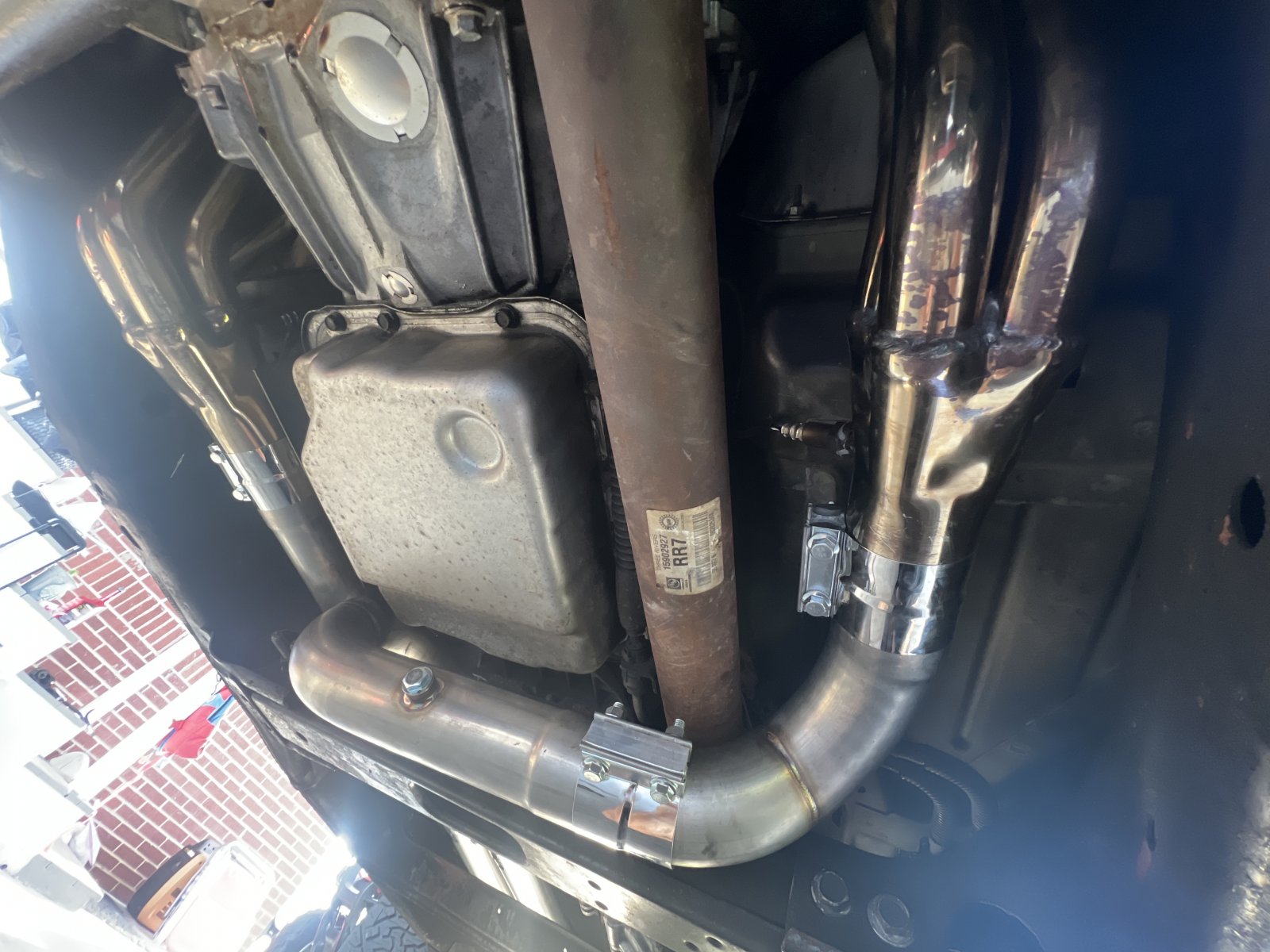

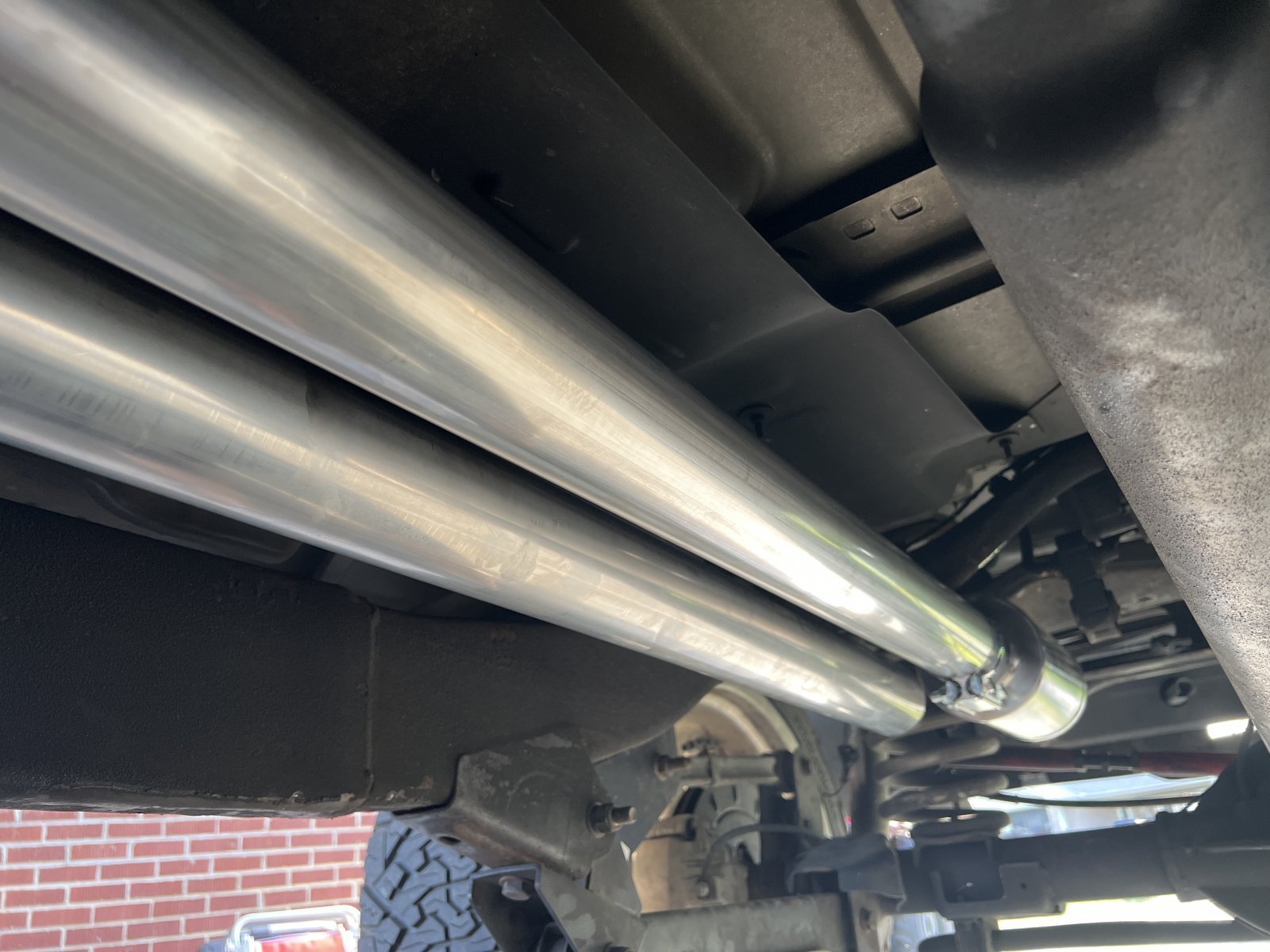

Any decent muffler shop could make one for you pretty easily.
cant find the pic of how it’s ran over the axle
The speed engineering clamps suck I had most the joints welded up minus the x pipe to the headers so when I serviced the transmission I could get the pan off easily but on my truck it’s got a leak on the driver side header collector so i need to have that welded up if the time comes I’ll just cut it with a sawzaw and throw buddy another 20$ to put a bead around it again

Any decent muffler shop could make one for you pretty easily.View attachment 436154View attachment 436155View attachment 436156View attachment 436157View attachment 436158cant find the pic of how it’s ran over the axle

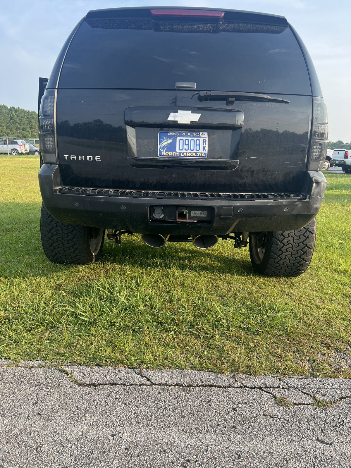

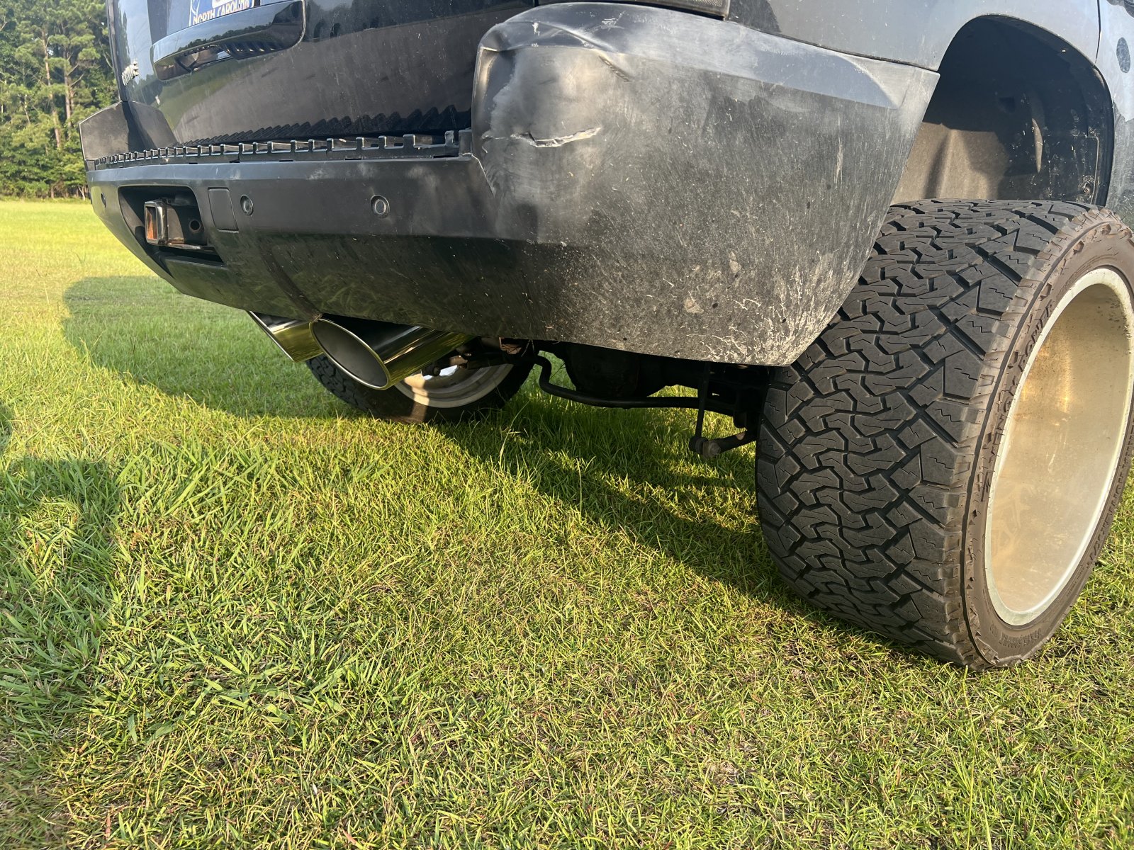

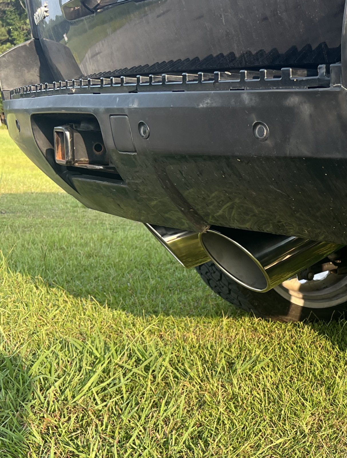

That looks legit! There's a pretty reputable shop by me, I'll hit him up about the equalizer. What does yours look like.?
Mine dumps under the 2nd row. I had a gibson cat back on it before going over axle, wasn't impressed. So I'll keep before the axle. The gibson sounded pretty good tho.
With the no cats going before the axle could stink up the inside of the cab pretty bad that’s why I ran mine towards the hitch facing back a lil bit
Before I got the tail pipes made up I could definitely smell the exhaust I wouldn’t recommend it
