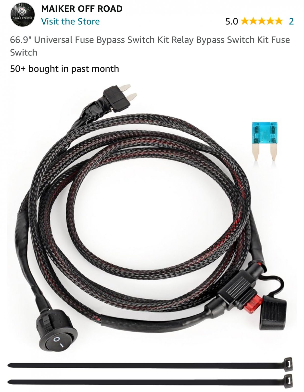

I am personally going to run a hidden kill switch to either the ECM ignition fuse or the ignition fuse to keep my 07 safe. I like the attached video, but would spend the extra time to hide the wires in looms and not use bright red wires. I like that it doesn’t require cutting any existing wires.
Actually, I may have found a much better solution that would be an easy install. I’ll keep everyone posted once installed. Will just jumper into the ECM ignition fuse with this solution…
