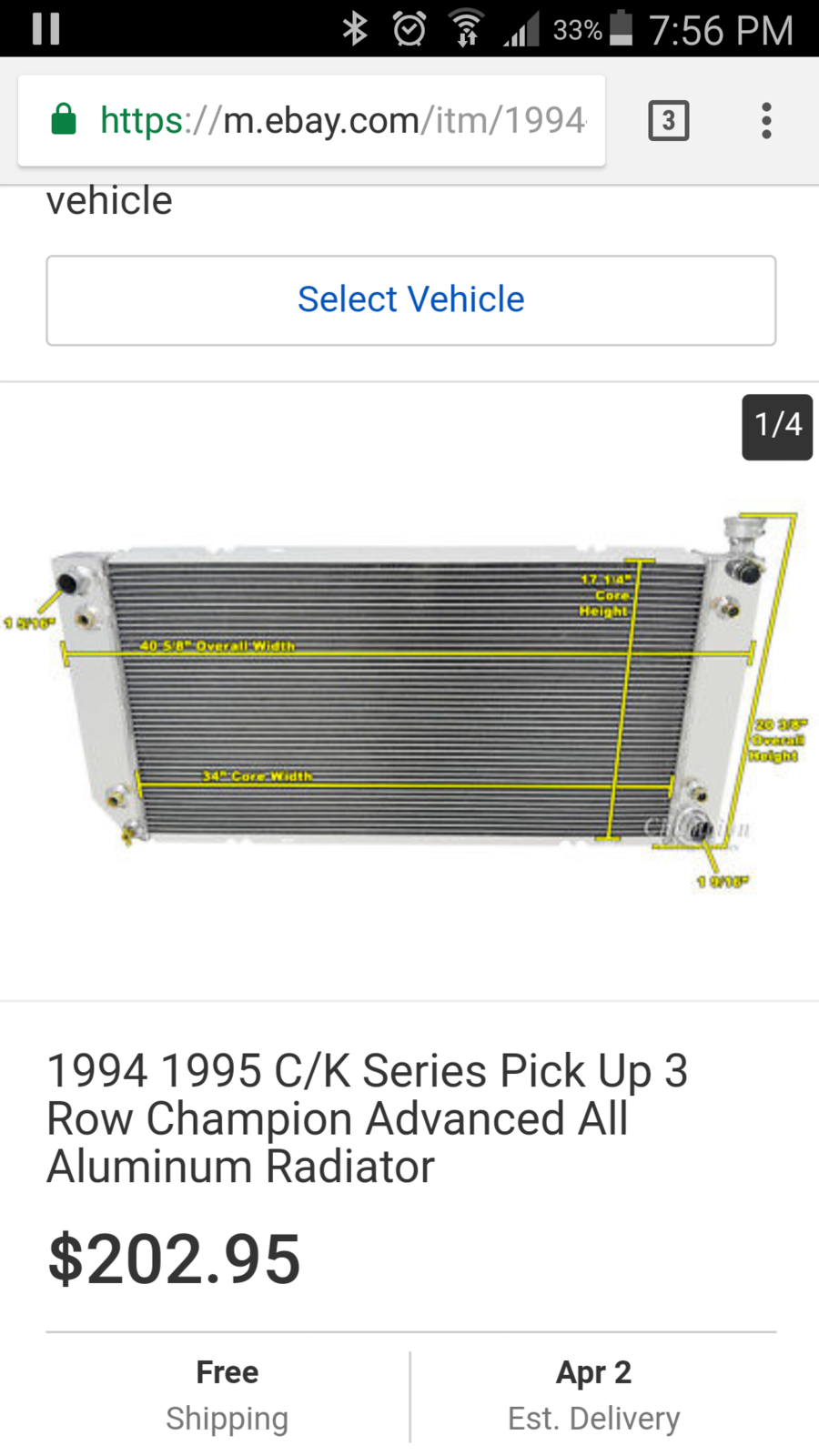

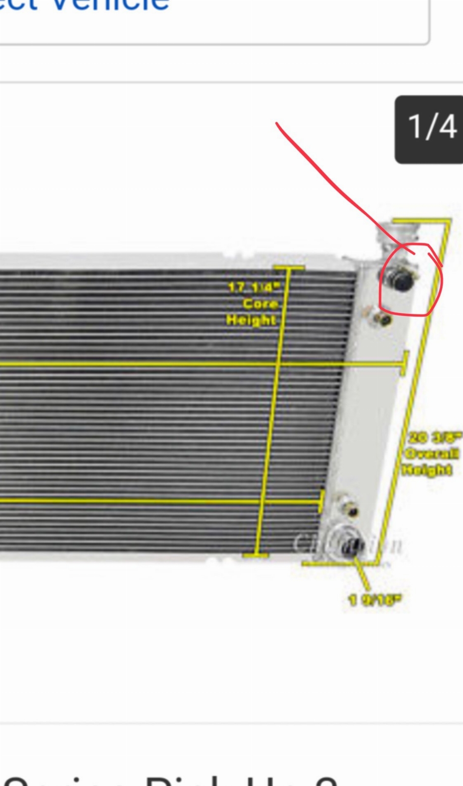

The most pressing issue it the radiator has a leak. I drove it today 50 miles and the engine didnt get hot though, anyway i spotted this on ebay. Lifetime warranty. Anybody use these?
Heads up, that extra port under the radiator cap and reservoir line is not needed and will probably come with a rubber vacuum cap clamped onto it.
I think that the earlier TBI trucks used it for the heater, but to make it “universal” aftermarket companies include it for all years. The cap can (will) crack with heat and can be a leak point.
On my truck, I didn’t know the difference and have an aftermarket radiator in it. I stuck a heater hose on the extra nipple and put a bolt and clamp on the end. It’s been fine for over a year...which is longer than the crappy vacuum cap lasted. There may be another material option, maybe others can chime in.
On my Tahoe, I ordered a Delco radiator that matched the original and did not have the extra port. One less thing to worry about.
Nice truck, by the way. It’s a nice color combination.

Thanks for the radiator info, maybe i can have my buddy weld it up.... that would probably void the lifetime warranty though
99tahoecolorado
19
My new radiator also had an extra nipple.. it’s in the to do list.. So I’m all ears if someone has a long term solution.
