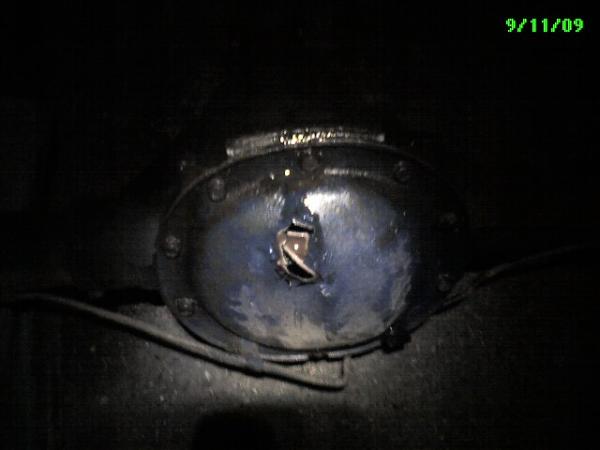

Hey all. Just getting home, 100 feet from the driveway, when bang, crunch, crunch, crunch, screech. Rear end spider gears just ate themselves. I just drained/filled the diff today, and saw the carnage in the poor thing, but thought I had at least a week (and another paycheck) to get a new (used) rear end together. The rear end decided to turn again after abruptly stopping, so I got it off the road, and then got it home using the brand new front differential in 4wd!!! Yay!!!! :winner_second_h4h::puke:
I actually had the differential open today for it's first time, and saw how bad it was. The ring gear looks great, so I'm assuming the pinion gear is good too. No major wear, surprisingly.
Can I just unbolt the differential from the carrier, unbolt the ring gear, and replace the gov-lock unit with a real posi, without having to redo the backspacing? :help:
Redoing the backspacing gives me the creeps, and I've never taken a differential apart before, so i'm really not in the mood to butcher my wife's rig with my first dabblings. I'm now destitute, too, so this needs to be on a budget.
Opinions, please?
Edit: Looking at it in the light, one of the spider gears actually went through the cover, and shot down the road. So I'm looking for a new rear end. Thanks for playing!!!
