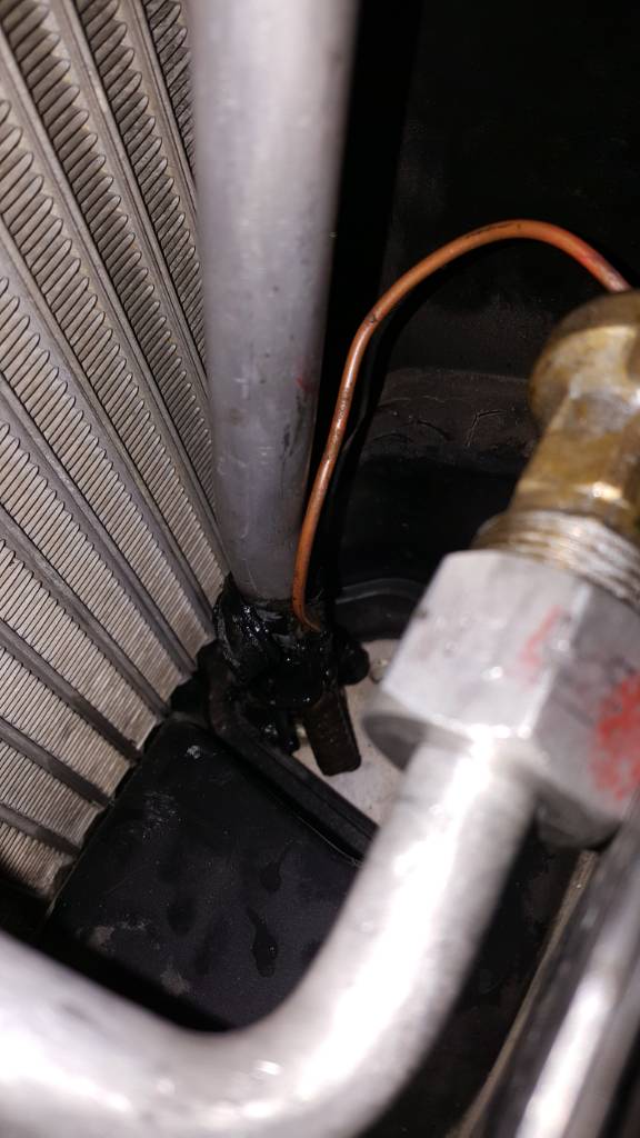

I am trying to find the thermal paste to apply bulb for new expansion valve. Where do you buy this stuff? Black stuff on hose at bottom of photo.

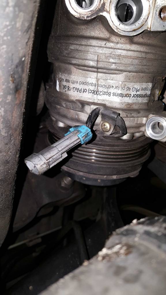

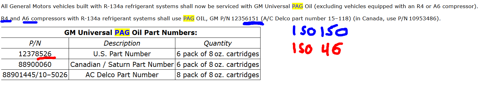

Any idea what PAG oil this truck takes (2001 Z71 Tahoe w/ rear air and 5.3L motor)? I have factory service manual and calls for PAG GM Part Number# 12378526, some searches on internet say that's PAG 46 others say it's pag 150?
Grab the part number from your compressor
From what I can find, original spec was PAG150. Some units were updated to PAG46 via TSB.
I couldn't tell you the reason for the change, or which, if any, is more desirable.

I got lucky... pump says pag 46 right on it :) ust trying to fish it out now. I think i have to take the cooling fan off but not exactly sure how.
