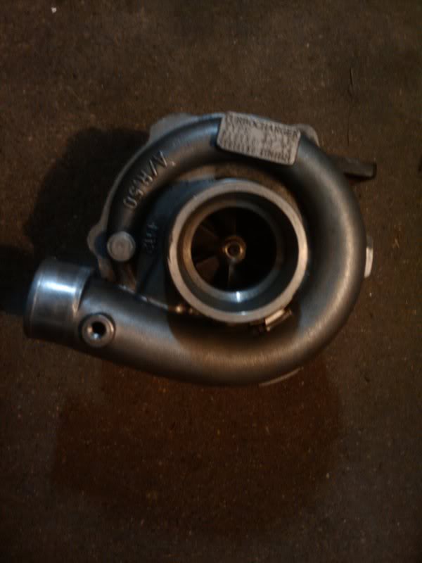

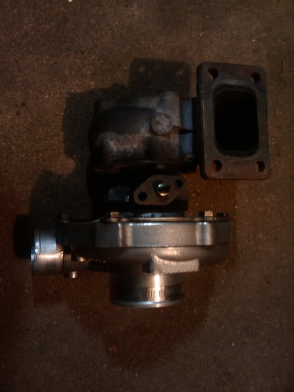

i bought this.
me and my buddy are wondering how much the stock internals can handle. cus now he wants to boost also(he wants to beat me) how many psi can stock handle?
