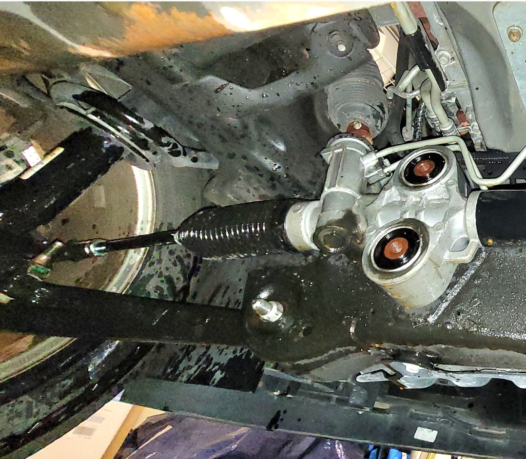

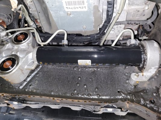

I replaced inner tie rods on both sides today. I REALLY had to put a lot of effort into breaking free the inner tie rod mounts. I'm guessing that destroyed the rack. Maybe I was supposed to use a backup wrench. When I started the truck, what I'm pretty sure is power steering fluid sprayed forcefully all over the floor, the underside of the engine, even up onto the bottom of the open hood. It was dramatic
Is this for sure my power steering rack failing? Are the reman units on RockAuto worthwhile?

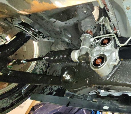

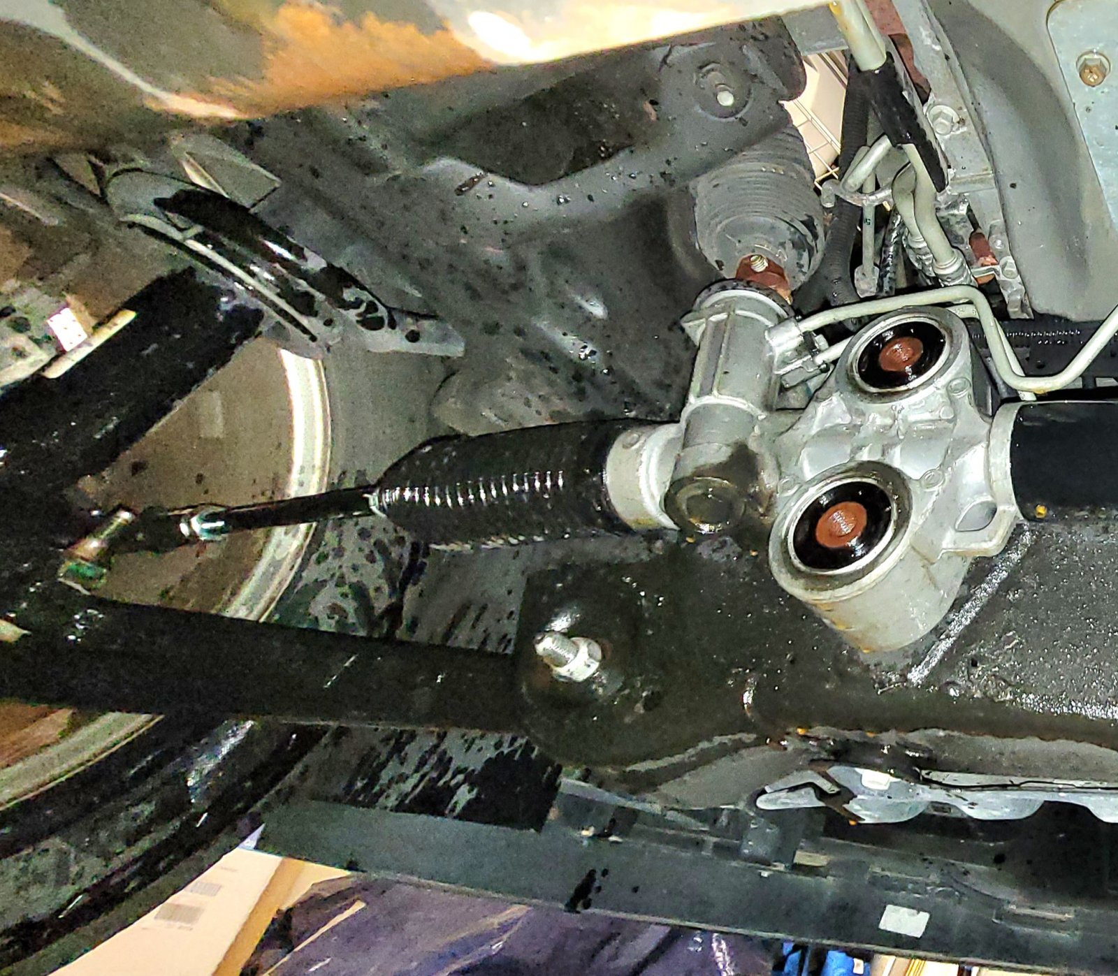

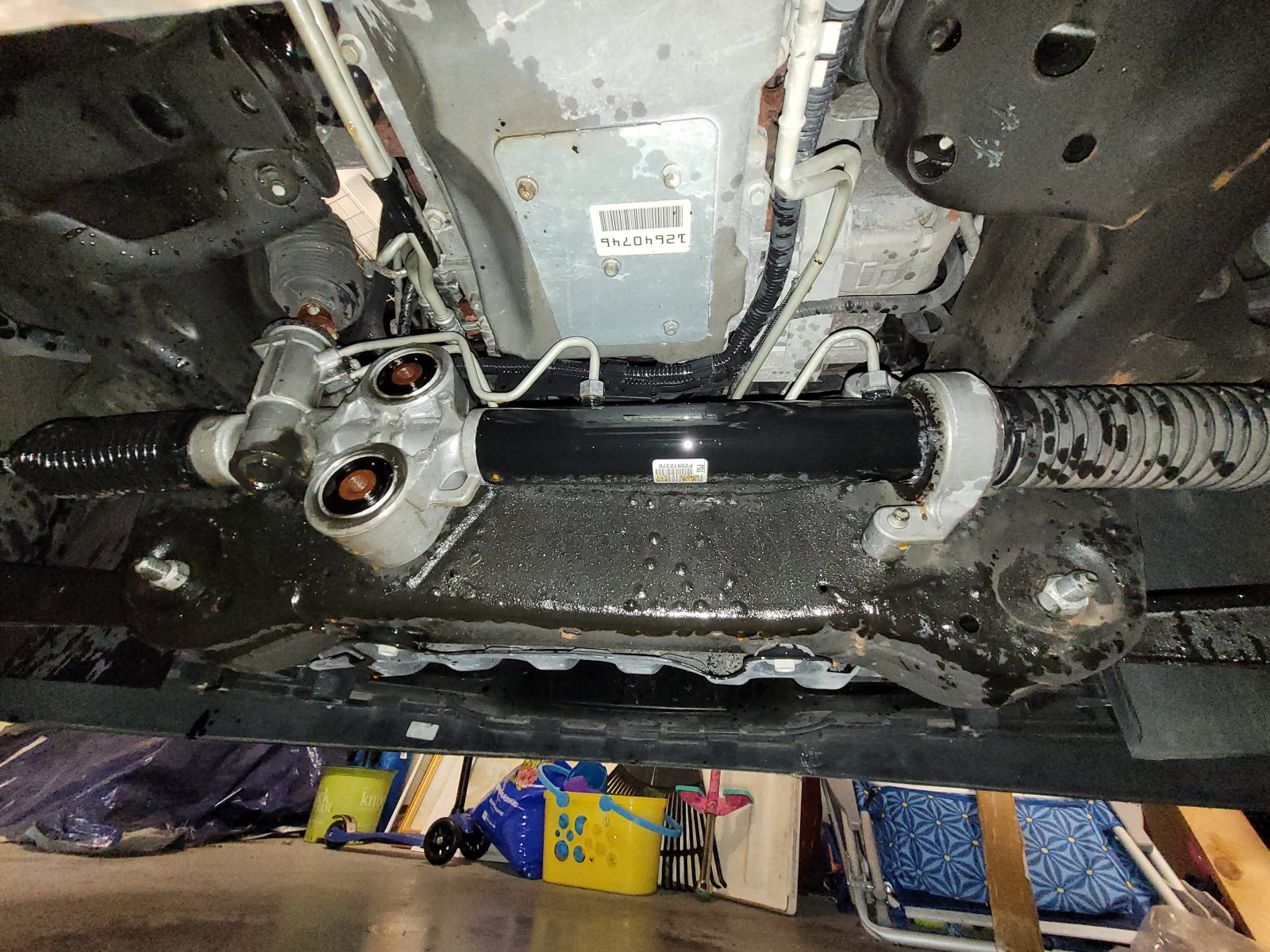

Where is the fluid coming from?
Hard to say for sure as I didn't witness it. I will have to crawl back under the truck, but it's a big mess under there. I needed 3 bath towels to clean up all the fluid.

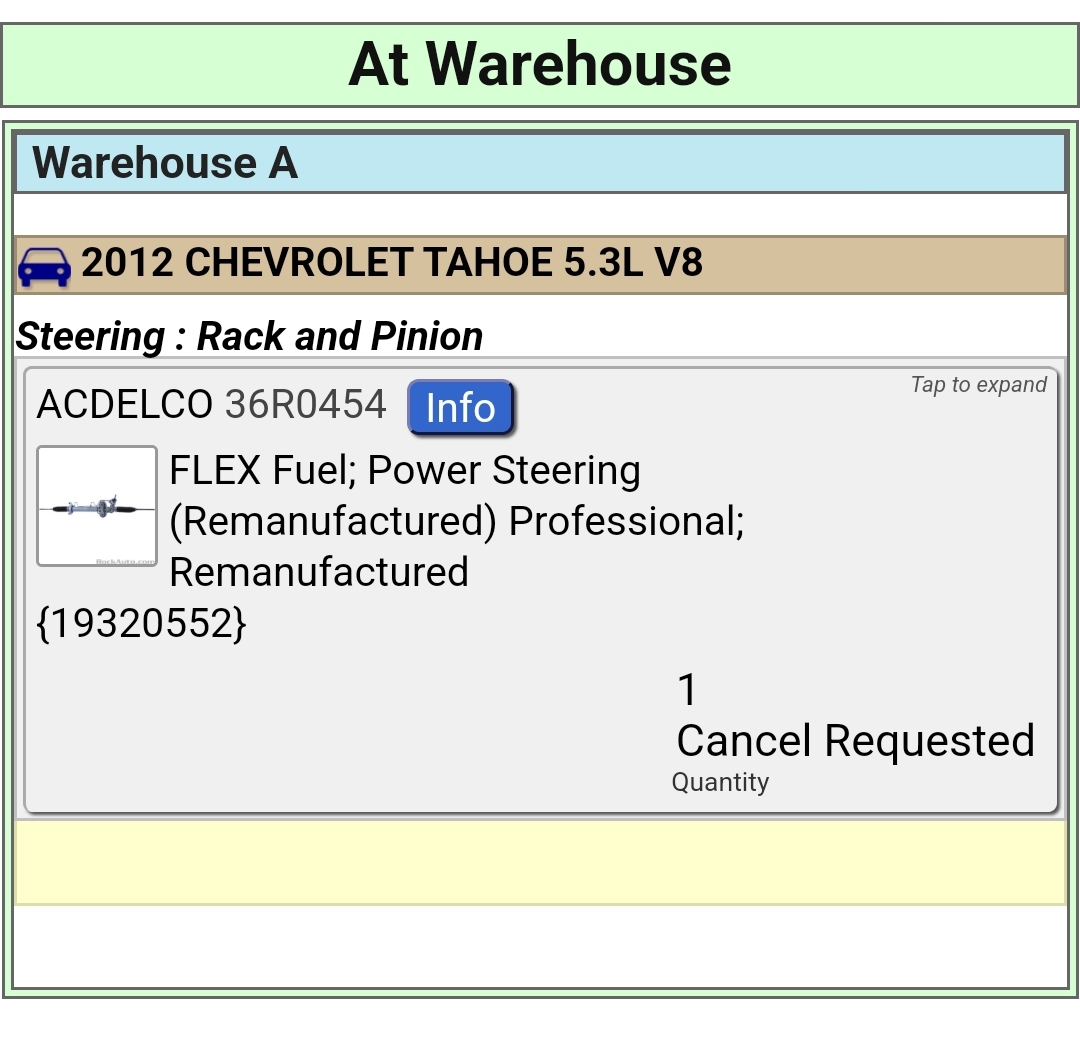

I noticed the boot on the driver's side is soaked, and the tie strap blew off that boot common to the rack. The clues I have point to the rack. I'll have to do more investigating. I went ahead and ordered a new rack from RockAuto as they only had one reman AC Delco unit in stock. See photos

Well I feel like an idiot
The old oil filter gasket stuck around, and I installed the new filter on top of it
The 'fluid' that sprayed actually came from the oil filter.
Note- fresh oil smells and looks a lot like power steering fluid
Derp
