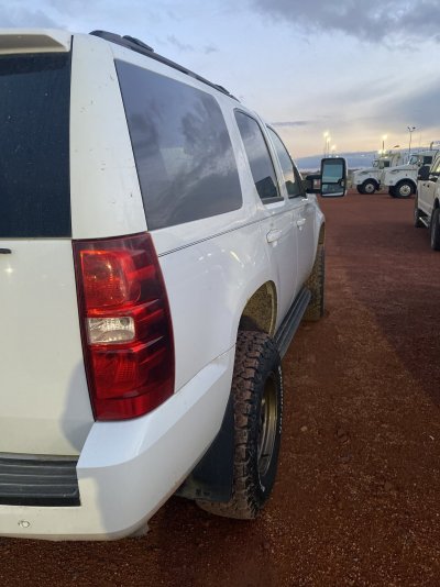

So Ive been running some aftermarket tow mirrors for about a month now and overall I am very pleased with them, however I’m having 1 slightly annoying issue with them. My Tahoe has the memory feature for the mirrors and since the range of motion and motor speeds are different on the new mirrors, sometimes when I get in the truck the mirrors are pointed all out of wack. This is causing me to have to adjust my mirrors almost every time I get in.
QUESTION: does anyone know how I can disable ONLY the memory setting feature for the mirrors?

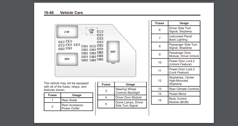

unless someone is adjusting the mirrors or pressing a memory button they should not move. PERIOD
so that being said there must be some other reason, maybe the door mirror switch is bad or funky or the mirrors have some internal problem.
possible fixes: test or replace door mirror switch
or pull a fuse #14 inside driver side panel
