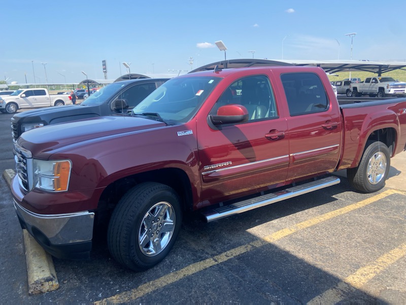

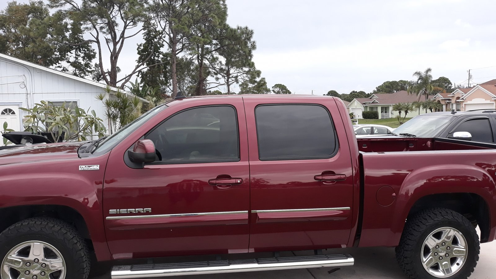

Hey Fellas,
So I made an appointment and my daughter took Sonoma Rose to get her windows tinted. I told the guy over the phone that I wanted it the same as my Yukon that they did, the maximum amount allowed by law. The paperwork for the Yukon says 30% up front and 20% in the rear, the regular ceramic. Well, Jaime comes home and it is not nearly as dark as mine and the paperwork says 30% for the front and 50% for the rear. I tried calling but the phone just rang, figured he was working on a car and hung up.
The windows from the factory are tinted and says 70% transparency for the front windows, 25% transparency for the rear side windows and 22% transparency for the back window.
For the front side windows, Florida law allows for, "a total solar reflectance of visible light of not more than 25 percent as measured on the nonfilm side and a light transmittance of at least 28 percent in the visible light range".
For the windows behind the driver, Florida law allows for, "a total solar reflectance of visible light of not more than 35 percent as measured on the nonfilm side and a light transmittance of at least 6 percent in the visible light range may be used on multipurpose passenger vehicles".
Found this little nugget in the statutes, "Every percentage measurement required by ss. 316.2951-316.2954 is subject to a tolerance of plus or minus 3 percent".
So, if the goal is get to 28% and the windows are already 70% from the factory, wouldn't they have applied 42% film on the front two windows?
And if that is right, wouldn't they have applied 19% and 16% film on the rears to get to 6%?
The photo of the red truck is before tinting. Let me run outside and take an after photo... Ok, third one is after with tint. What do you think?

I think the tint looks just right.
I had a new silverado that didn't have factory tint (crew cab). I was told to expense the window tint, so I had all 4 done. I never thought about tinting the driver window being from WI, but man was it nice. Looked similar to your truck with only 20%. Money well spent.......theirs anyway LOL
