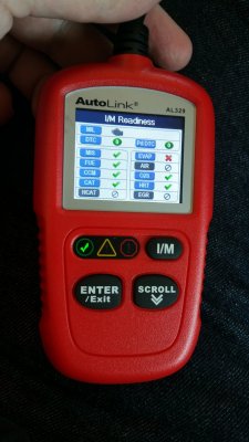

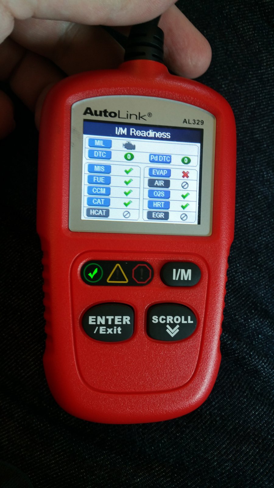

Here is the Denali as it sits...
Here is the Tahoe with a p0449 code...

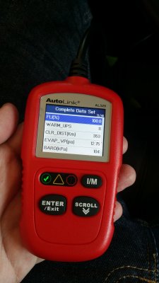

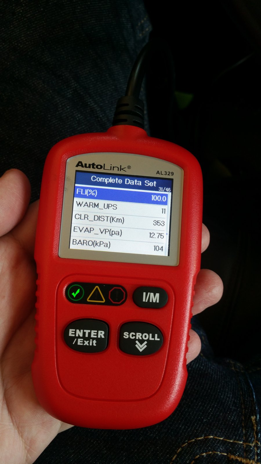

this is with 219 miles From FULL reset Battery disconnected (bought new battery)
It still Qualify to pass Smog in California we have the most strict policy on that stuff
No more P0069 so far :) :)
the one you want to look at is the EVAP_VP you will have to google the range value asi don't know

miles or km from last reset? is there any current codes or pending codes? or old codes? this may prevent from being ready..
