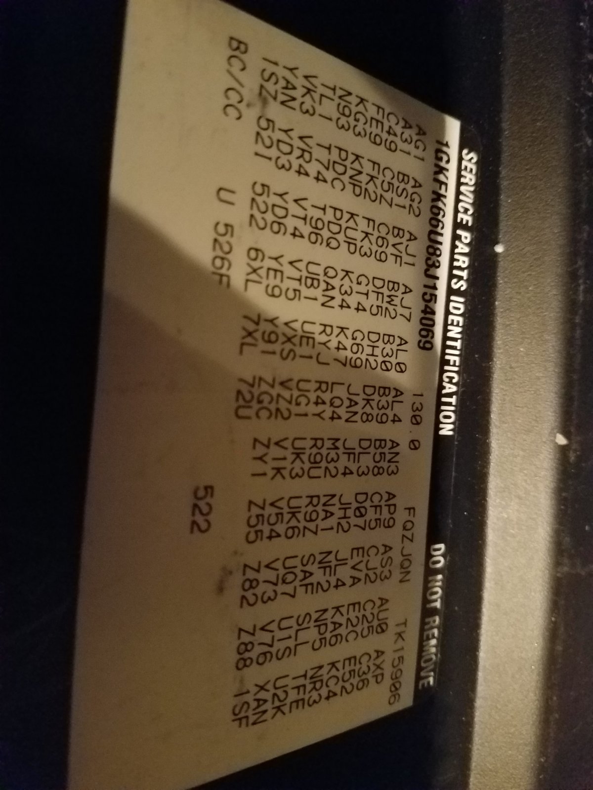

What year and model? 4x4 or AWD? (Im assuming its the Denali in your avatar) Look in glove compartment (dash) lid for RPO codes. Have a NP8 or NR4 there?

Here are my code sets... I see an NR3, not NR4, and a NP5, not NP8... what does this mean?
I looked on rock auto and there are multiple diff sizes..

Here is a little bit of what i found in a couple minutes.. hope this might help anyone scrolling threads.
RPO NR4 - AWD with 4 WD Low (AKA: AutoTrac)
RPO NR3 - AWD with out 4 WD Low (Denali)
RPO NP8 - Auto 4WD, 4WD, 2WD, 4WD Low
NR4 and NR3 use the same software algorithm to detect rear wheel slipage and put power to the front wheels, typically with in 300 ms.
Yukons come standard with limited slip rear unless the vehicle is equiped with Stabilitrac (begining in MY05, you can have limited slip with Stabilitrac).
Denalis come standard with Stabilitrac thus removing the limited slip rear and Stabilitrac is a option on the Yukons.

Your transfer case (NR3) is a Borg Warner BW4481 Transfer Case. Single Speed, Full Time AWD unit. DOnt believe anything is interchangeable with the NP246. But dont let this discourage you. They are fairly easy to rebuild. (Read as not rocket science). 2007 and up went to the BW4485 in the XL.
Heres one on ebay right now for comparison. https://www.ebay.com/itm/03-06-ESCALADE-YUKON-DENALI-TRANSFER-CASE-OPTION-NR3-23575-/263000098182
Not uncommon for one of the roller bearings to die. Typical for the output shaft needle bearing to growl and make noise and lots of it too.
