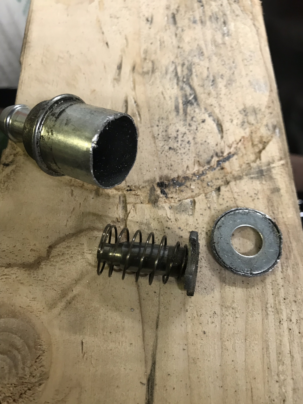

This wide open breather to the valve cover allowed oil to be sucked into the intake and puddled when it was off. Burned it while running. I only had 3 quarts of oil in the engine!! So I started draining what was left of the oil, I had no idea what oil was in it, and it was changed before I bought it. Had 80% oil life left but I figured I’d start over and run my Amsoil and K&N oil filter. What I did about the oil consumption was run a 3/8 hose off hollowed out PCV up by brake booster and put a small filter/breather on it for a temporary fix. I plugged off the vacuum line also. I was gonna swap out the valve cover back to the original but I found out there is an updated version of it that has different baffles to eliminate oil consumption. Ordered that and will swap it out once it arrives and do my coil brackets at the same time.

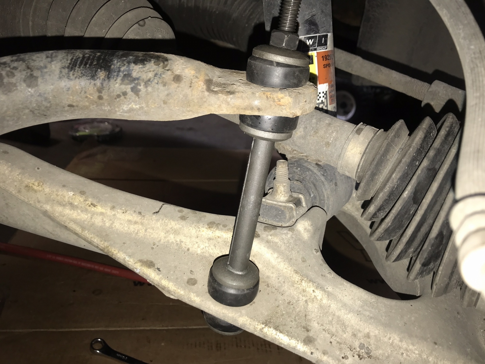

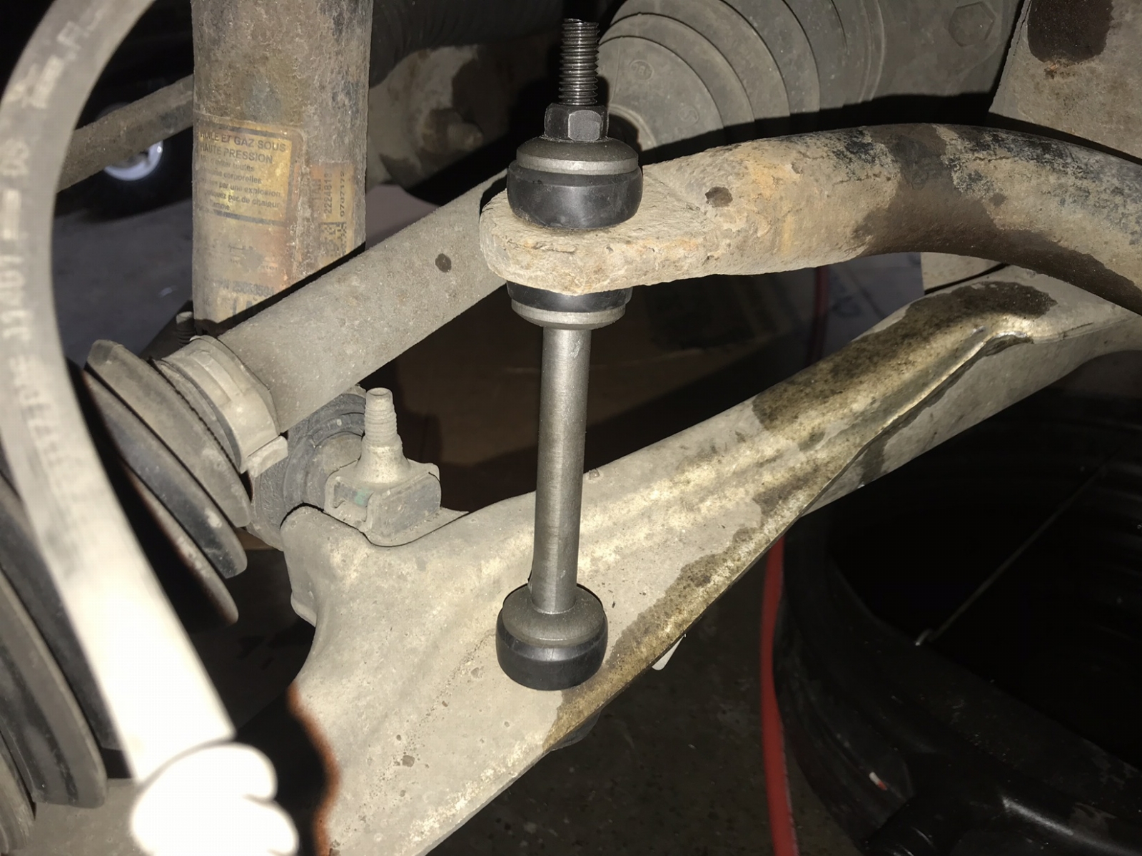

While I was under there I noticed the inside of he drivers rotor was ugly. Might as well get some brakes too. Seen the sway bar end link bushings weren’t that great of shape either so I picked some of those up as well.
$320 later I have the rotors, ceramic pads, end links, oil filter and oil. Then I got busy.

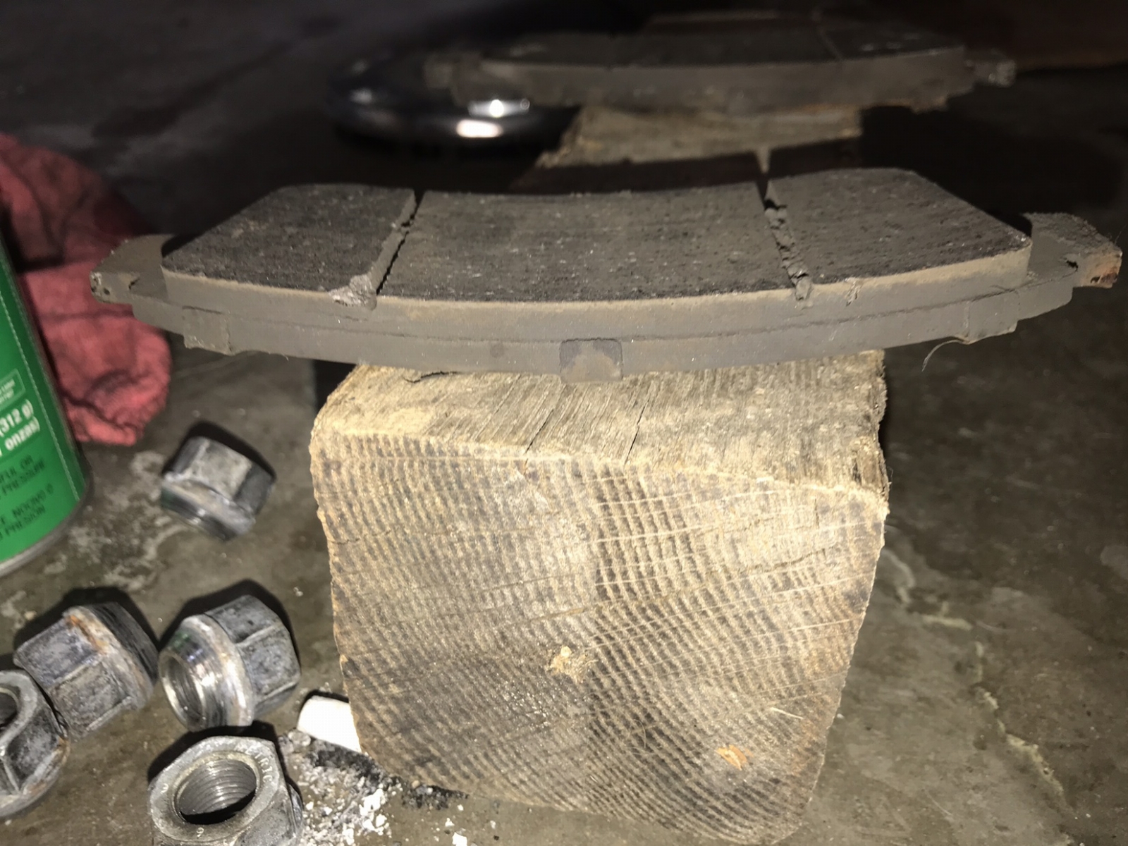

Driver side rotor outboard side.
And the outboard pad.
Inboard side of rotor.
And the pad.
It’s got a nice taper to it. Thankfully it was just sticking on the bracket and the caliper wasn’t bad. Everything else went back together fine.

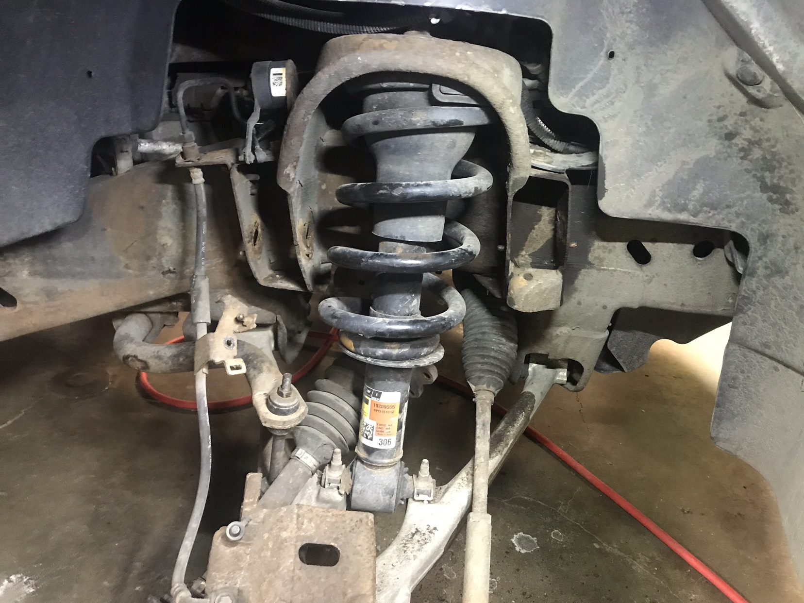

Making progress. I hit the ground running and had this apart besides lower ball joint out in an hour.
Pulled tire, and disconnected wheel speed sensor.
Removed tie rod from spindle and removed caliper and set it over the sway bar.
Removed ball joint nuts, pulled caliper bracket and rotor and removed CV shaft nut. Removed the 6 bolts on the inside CV shaft so I could pull that thru hub bearing. Spindle broke free pretty easily.

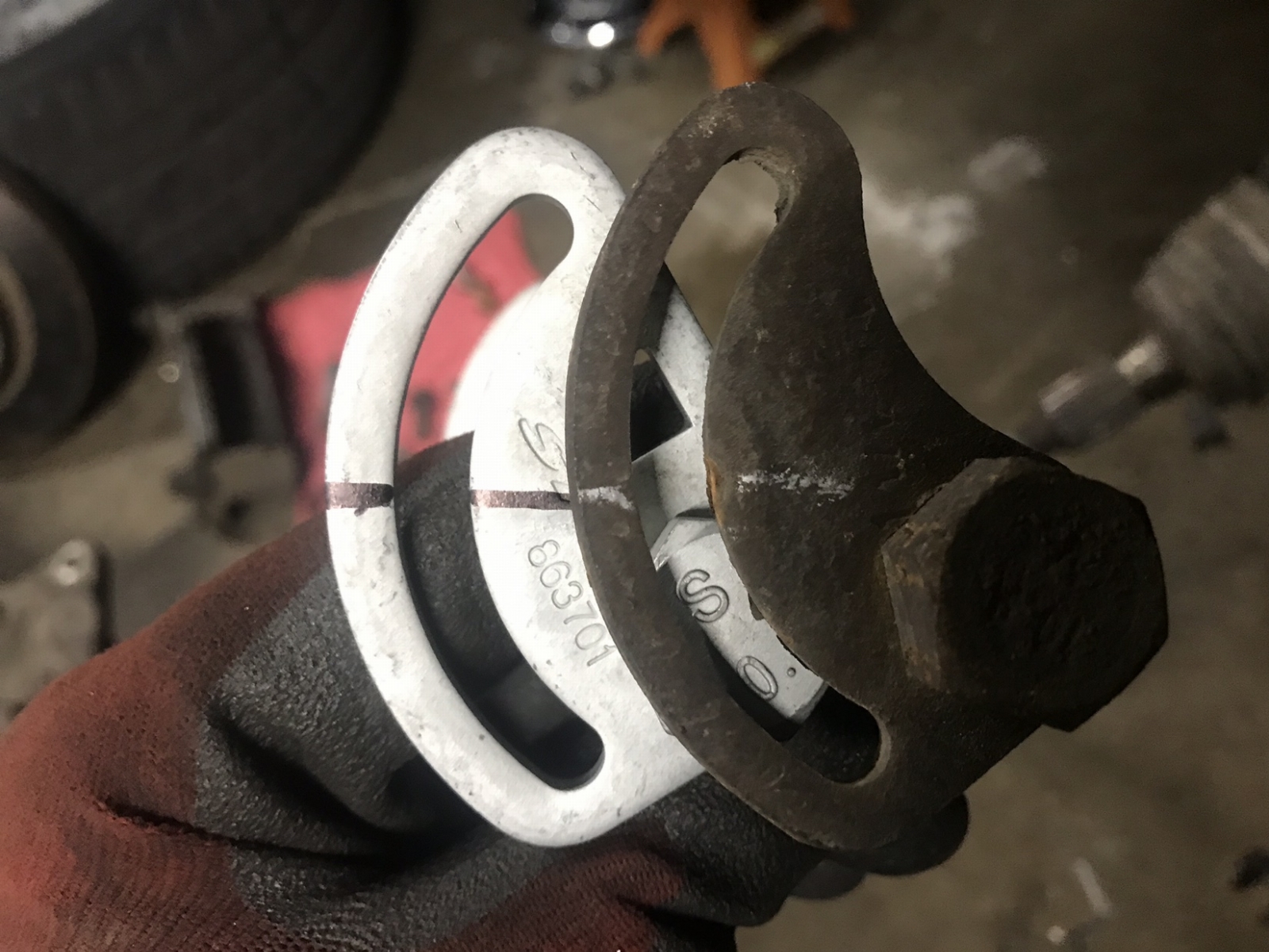

I marked the camber cams where the cam pins are so I can put them back as close to the same spot as they were. Then transferred the marks to the new cams.
One a-arm bolt broke but I was able to remove them with an air hammer. Then pulled the a-arm.

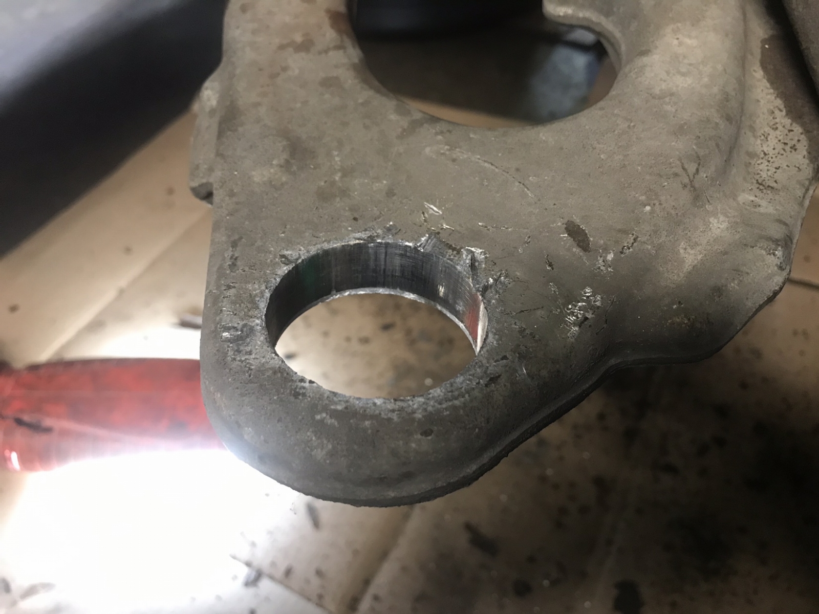

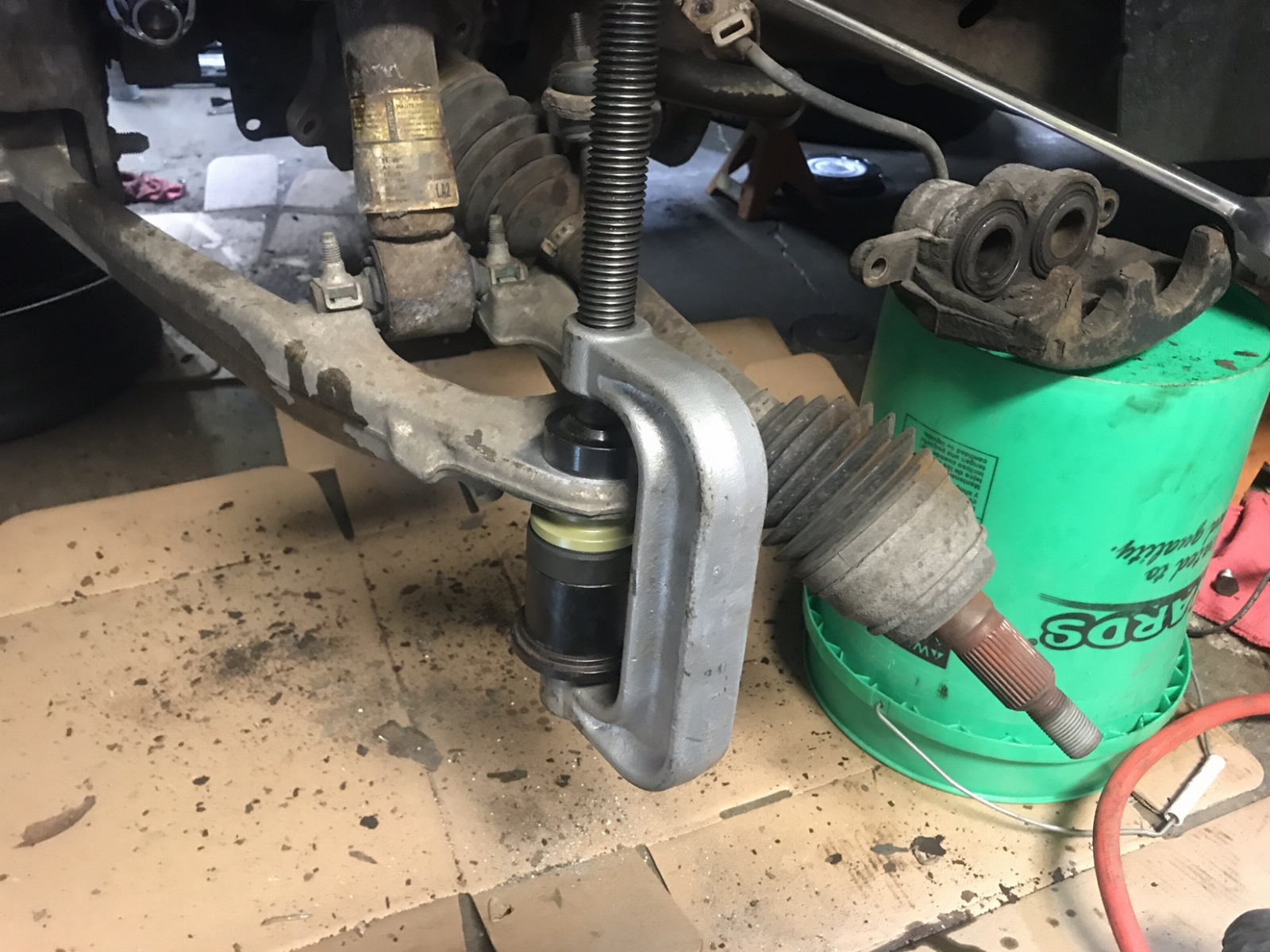

Bottom ball joint, just in case someone is wondering how this thing comes out and goes back in.

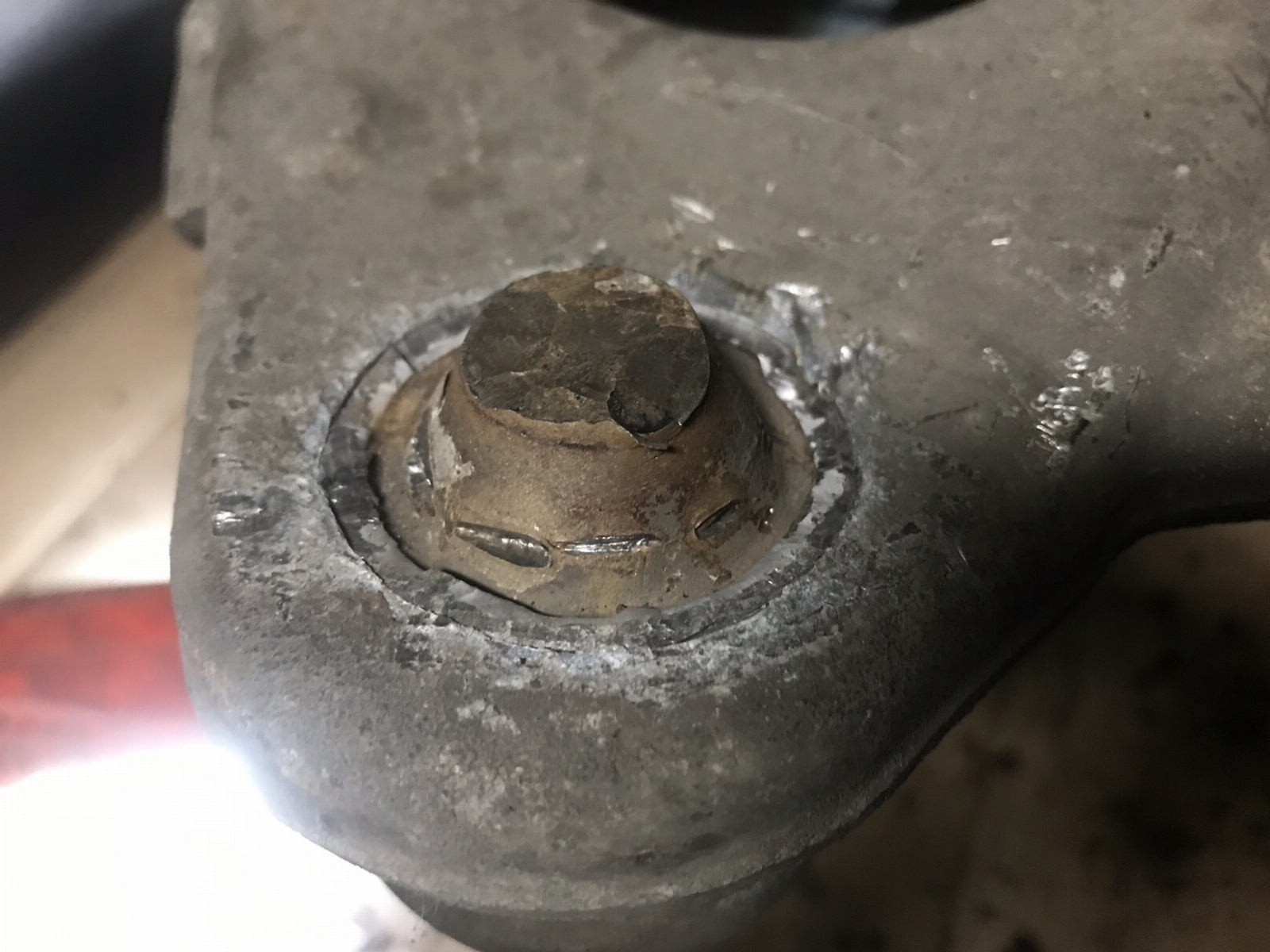

This is a factory joint. It has this sleeve that’s crushed over the top of the a-arm.
First thing you have to do is get a chisel and a BFH and chip off that ring as flush to the arm as possible.
Once it’s chipped off, take your BFH and smack the top of the ball joint. Keep beating it like it owes you money. You’ll see it start to move.
It’s starting to remember that 20 spot I lent it.
Now I’m starting to call it by my exes name.
You don’t want to hit the arm and nick it so take your chisel or punch and knock it the rest of the way out. By this point it’s surrendered.
I cleaned up the top of the arm and sanded the inside slightly. No need to go crazy.
Now take your ball joint and put it in your press and get some good tension on it. Be sure you have your grease zerk lined up where you want it.
When you have tension on the press, smack the arm on the sides where there’s plenty of meat and the joint will jar it’s self in a little. Put more pressure on joint and repeat. It walked in but it needs that little jar to keep it moving straight. I could have impacted it but if it goes crooked you can ruin the aluminum arm or even break it. I find a few snacks while pressing works best.
We’re in. No problem.
