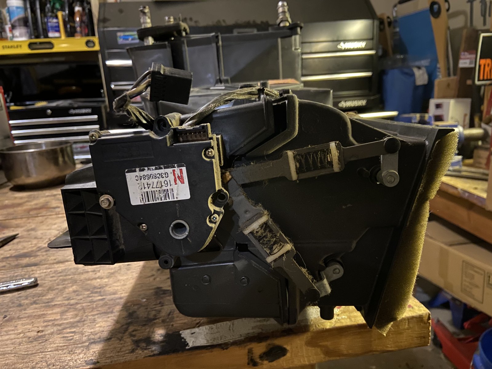

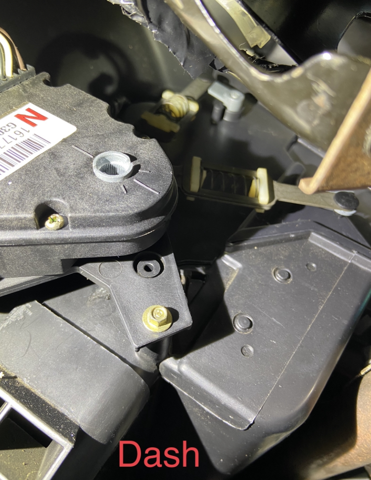

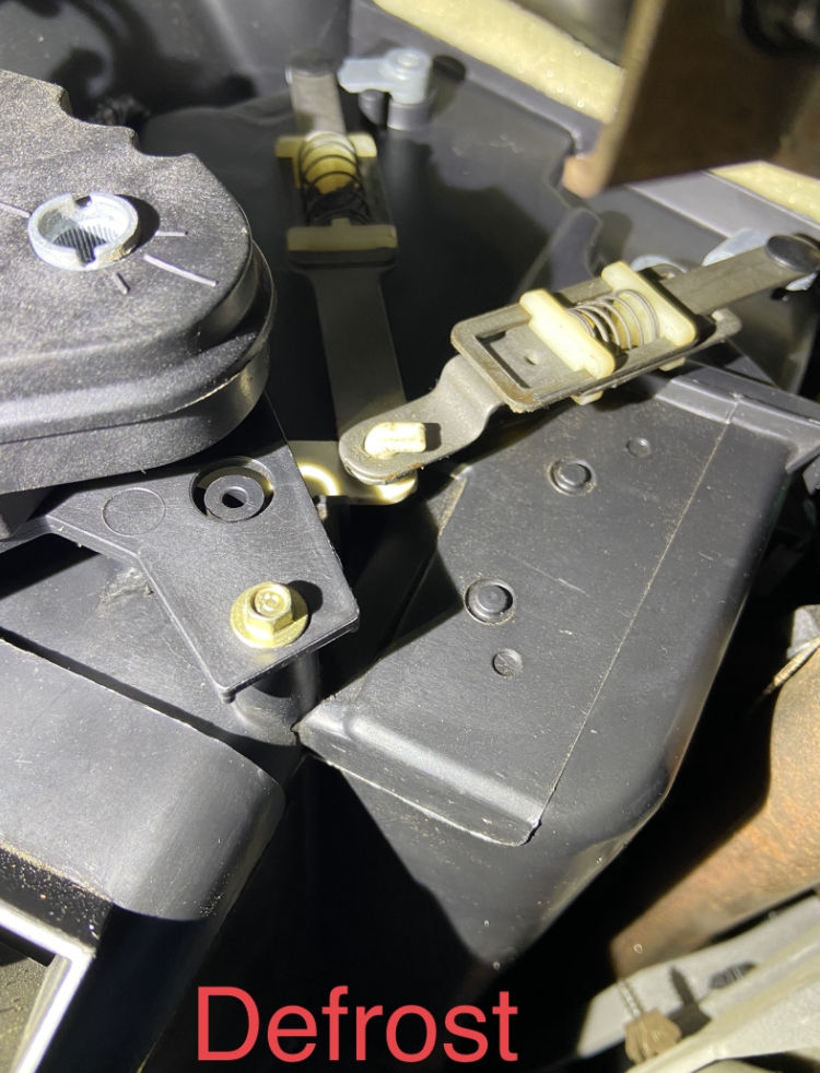

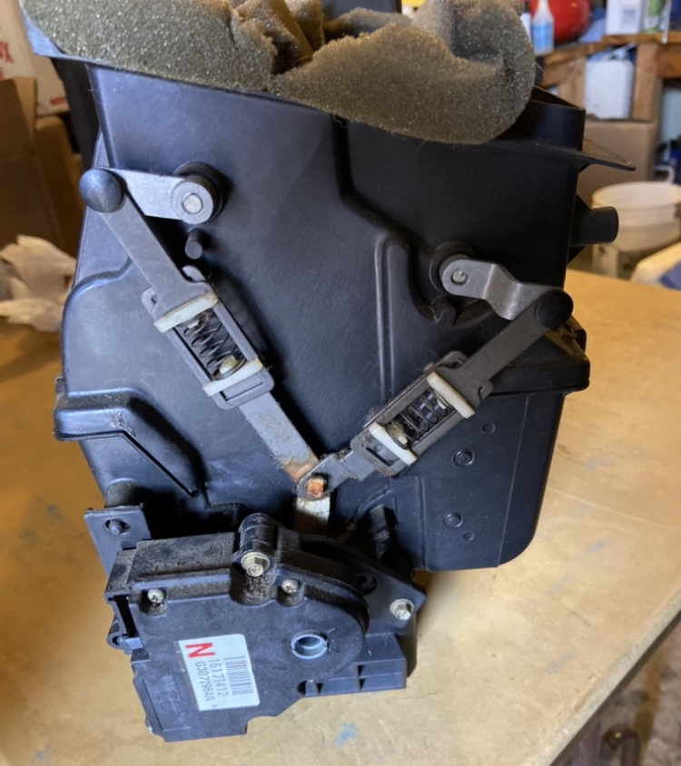

The notched silver dial on the actuator doubles as a position indicator as the dampers rotate. See if it matches the photos below. It should turn smoothly as the dial setting is turned, no jerking back and forth or rhythmic ratcheting sounds. Compare the linkages as well to make sure they’re intact.
