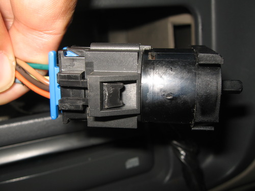

I think I found out why my 3rd speed wasn't working, popped off the HVAC unit and saw this behind.....
Previous owners must have been real cheap asses, looks like they had the wires connected to the unit with electrical tape.... Anyway I ordered http://www.amazon.com/ACDelco-PT1346-Female-8-Way-Connector/dp/B000C9TZBY/, does anyone have any tips on how to get my current wires replaced? Looks like they go way back into the front of the vehicle, and are currently wrapped up with the other wires that plug into the HVAC unit. Already replaced the heater blower control switch since I figured I might as well since the HVAC unit is out.

it may be in your best interest to run new one if you can not attach to existing ones.
---------- Post added at 08:59 PM ---------- Previous post was at 08:57 PM ----------
that kit just attaches to those in the pic now just cut off the old terminals. crimping might be better tho. wait to see any instructions first.

Here is the schematic sheet I'm using. I think I can actually just reuse my wires and leads without connecting any new ones. I really just needed the female plug, although of course you can't get that for just $4, you need the whole $30 kit.... The amazon picture looks like you just use 6 cables, and I see I only have 6 free cables. I probably will end up just cutting off the terminals on the current wires, and soldering an inch or two of the new wires + terminals onto the ends.
This picture is from Amazon, unfortunately he does not show the back end of the plug.
However I can't tell which colors exactly are running into each of the inlets. According to my schematics, I should have dark green, brown, orange, light blue, tan, and yellow.
The 6 wires I have are dark green, brown, orange, light blue, tan, and yellow, so far so good :D
However my schematic calls for something different, unless I'm looking at the wrong schematic. It says it should be for 95 and up trucks, and it's from the Haynes manual. Maybe someone can take that Amazon picture, and use MS Paint or something to tell me exactly which color should line up with which inlet?

I saw another Amazon pic where it looks like:
top line looks like blank, blank, brown, orange
bottom looks like green, yellow, tan, purple
Let me know if that matches up with what you find.

Can anyone get me a picture of behind their HVAC controls? Really curious as to which colored wires go where and I'm not willing to risk it based off the Amazon picture :p
