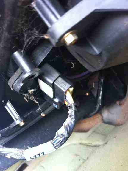

PwtrSS_OakCliff
PwtrSS_OakCliff
Dec 11, 2011
359
Dallas, TX
Is this the module? I went to junkyard yesterday but no lock. Seems all of them were already taken. I tried a z71 truck 00-06 but it had more wires and the plug was longer. Then took one from an Envoy but it was shorter but bigger. Could not find relay.
Antonio

BRUTUS_T_HOG
Dec 7, 2012
218
Yes the blower power module is very common failure and easy to test.
There is i think 3 wires, there will be 1 small wire. All you need to do is check with the key on and check the voltage on that small wire. It needs to change voltage when you command a different blower speed, if it DOES change then the blower module is bad.
The blower module is just a small computer that replaces the blower resistor in a normal blower set up, sometimes the connector will also be badly burned
