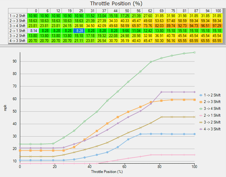

Weird, I assumed the 10-14 tahoes would have the same tcm, but the layout in hptuners is different for '10-'12 and '13-'14.
The '13-'14 layout resembles the '15+ shift schedule layout..
I'm convinced the 2015 schedule is an improvement, as well as some other settings.. torque adder (shift time), inertia profile (shift feel) settings, adder modifiers zero'd... Since you have a 3.42 rearend, the closest I could find in the tune repository is a 2015 GMC Sierra 5.3 that is also a 3.42 ratio.
In case you get bored and want to test it out.. Because I wonder if it's in my head, but I've switched back and forth a few times (not the schedule, but those other settings) and everytime I feel the 2015+ settings are an improvement.
Here's a gif I made of '12, '15, '17 shift schedule (3.08) gears 1-4..

If only that .gif could be slowed down, or paused ...
But study that .gif long enough, it's a basic beginner's wordless instructional on how to tune a 'Normal'* shift table for a more responsive transmission.
*Please note: 'Performance' mode, 'Tow / Haul' mode, 'Eco' mode, 'Valet mode, etc, each have noticeably different philosophies.

Yup, hoping the bump in upshift speeds at low throttle will help it from shifting early when easing off the throttle such as entering a turn or just slowing temporarily. That's what I'm most excited about.. Have bumped those speeds myself, but sometimes forgetting to reset adaptives and reverting back closer to stock to maintain the smooth shift.
Then there's the 3-2 downshift that is reduced below 50%, but higher above 50%.
Some refinement that I wouldn't have gotten done by myself, big time saver for me to start with the later schedule..
5th and 6th maybe a different story.. still looking at those..
Not saying someone ELSE couldn't do better all around, just not me..
Slower version..
Slower version..
