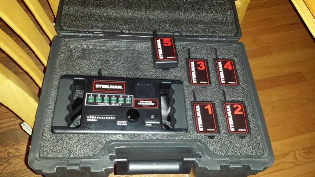

well I bought Steelman's ChassisEar...wireless mic system. will hook it up this weekend to figure out the problem. also I sill check the rear diff. Pumped!
