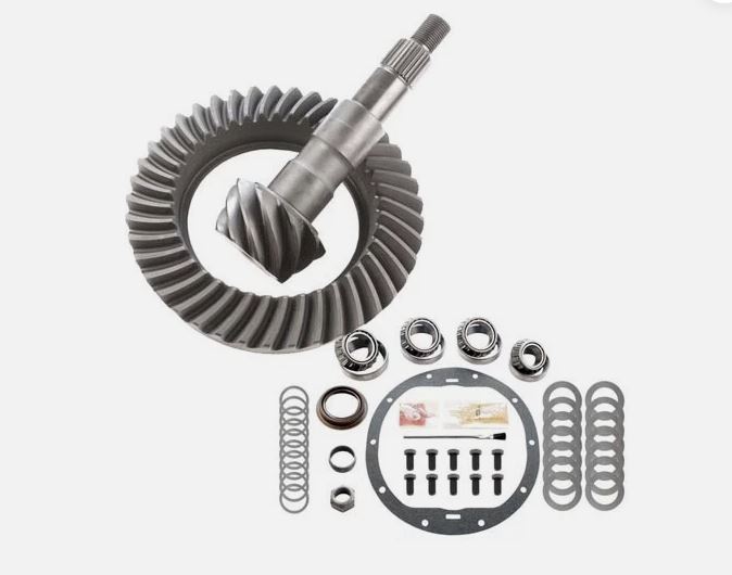

I would be looking at the pinion bearing, if it is leaking there then you can almost bet money it's the source of the noise.

would this not have been replaced when i got the diff replaced about 9 weeks back? not trying to sound smart I just dont know
Not unless it is on the invoice and you paid for it. there is a yoke, ring & pinion, bearings and seal, separate but attached to the drive shaft & rear diff.
it would be listed separate on your invoice.
the pinion is what determines your rear axle ratio, i.e. 3.08, 3.42, 3.73, 4.10 etc
