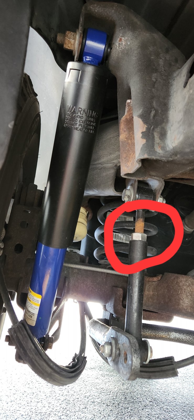

I’m using 4” Maxtrac rear springs. I can’t confirm that they are an actual 4” drop since I had multiple springs before finding these that I liked. I have both a SWB and LWB and both have the exact same suspension setup, I had to use the shorter rear links on both.

Do you have a part number for the shorter links?

I want to say it was the 7960, that looks to be the shortest one they make. I believe the sway bar kit comes with the 7961.

in all cases I would use blue locktight, and/or as noted double check them once in a while they have a tendency to work there way loose end links and d bushing bolts, front and rear
