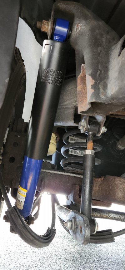

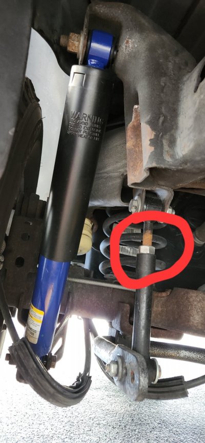

Good stuff. I finally fixed my rear bar. Wasn't parallel to the ground--it is now. Weird thing is i had to take the jamb nut out to get it where it needed to be.
Due to the mechanical "sway movement", be sure the fittings don't move. ( Check in a week )
Take a picture... It should look like mine..... Is your suspension height, modified?
( After looking at the photo of mine, there may not be anything that will 'turn'...... But the vertical link should be solid and not move independently, from the bushings?
Yeah, I'm lowered 3".
This is the jam nut I had to take out for the bar to be parallel to the ground. Yukon new rear shocks.jpg
If i didn't take it out i wouldn't have been able to get it as low as it needed to be.
