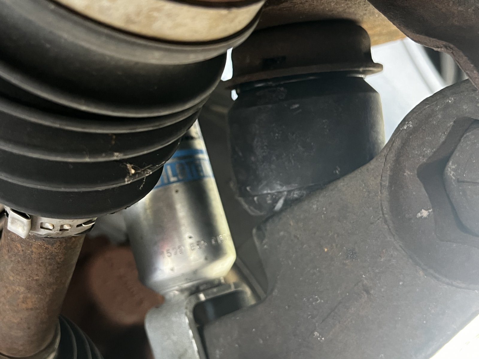

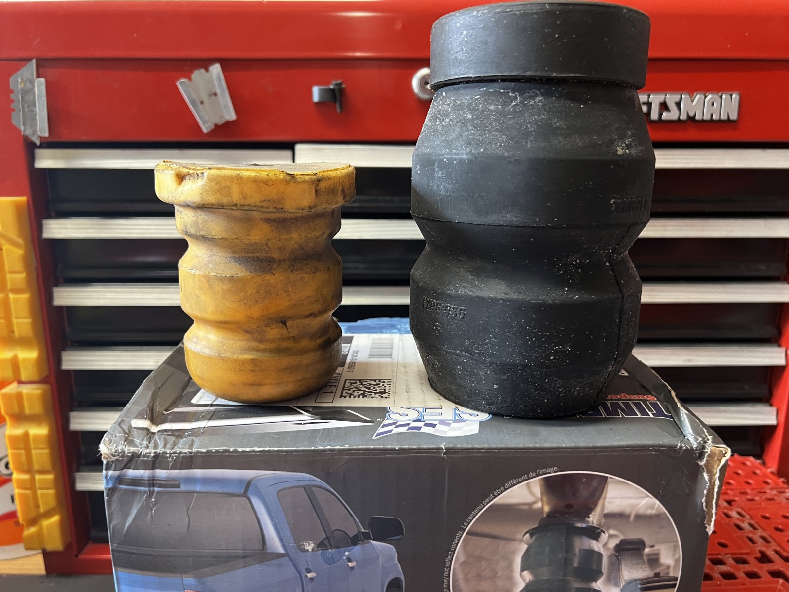

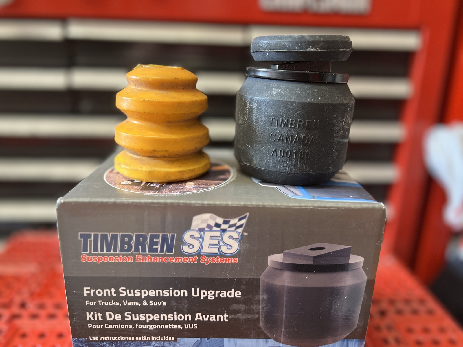

This may not get you off the Tilt-a-Whirl but be sure that the front jounce stops are contacting the lower control arms at ride height. That's a fulcrum point in the front suspension and having a gap or no jounce stops there can cause ride and handling issues.
Agreed.
When my 03 Z71 was leveled, the front jounce stops no longer contacted the LCA.
Replaced them with Timbren front jounce stops that are much firmer / longer and are in contact with the LCA.
Also using Bilstein 5100 series shocks @ all 4 corners with Airlift bags in the rear springs.
Firmed up the ride considerably.
FRONT:
