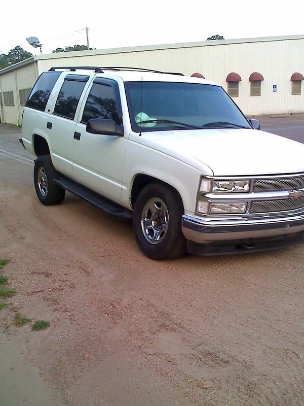

You could do what I did for accidental removal and forget to put the axle nut back on while installing a lift kit haha.
