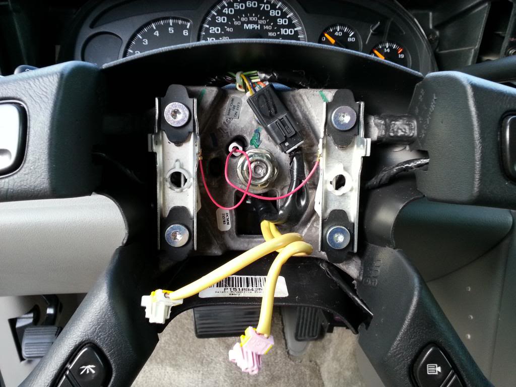

2. Release the airbag by inserting a small screwdriver in the two tiny holes in the shroud behind the wheel and pressing the release. It will release very easily.
3. Disconnect the two airbag wires by pressing in on either side of the connector.
Here is what you see:

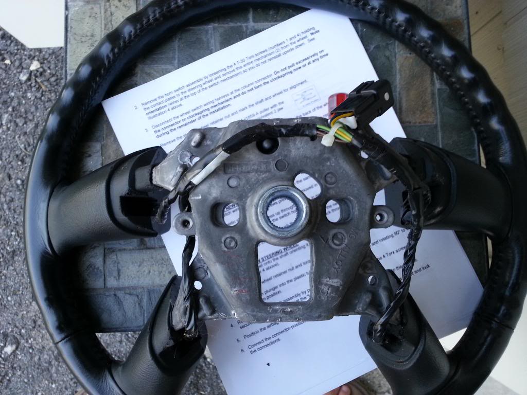

10. Remove the shroud on the back of the wheel which is held on by two torx screws.

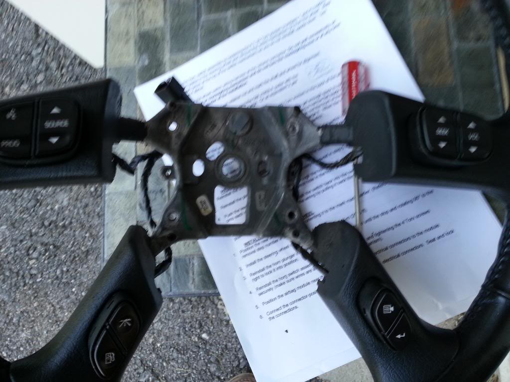

11. Remove the steering wheel buttons by pressing firmly on the switches from the back of the wheel. They are basically just held in there by friction and are not clipped in. They just need a firm push.
Here are the buttons once I pushed them out:
12. Disconnect the switches once clear of the wheel.
13. Remove the wiring harness and put it on the new wheel.
This is how the harness is routed on the back of the wheel:

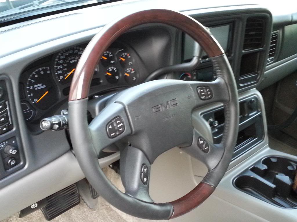

Here is the finished product

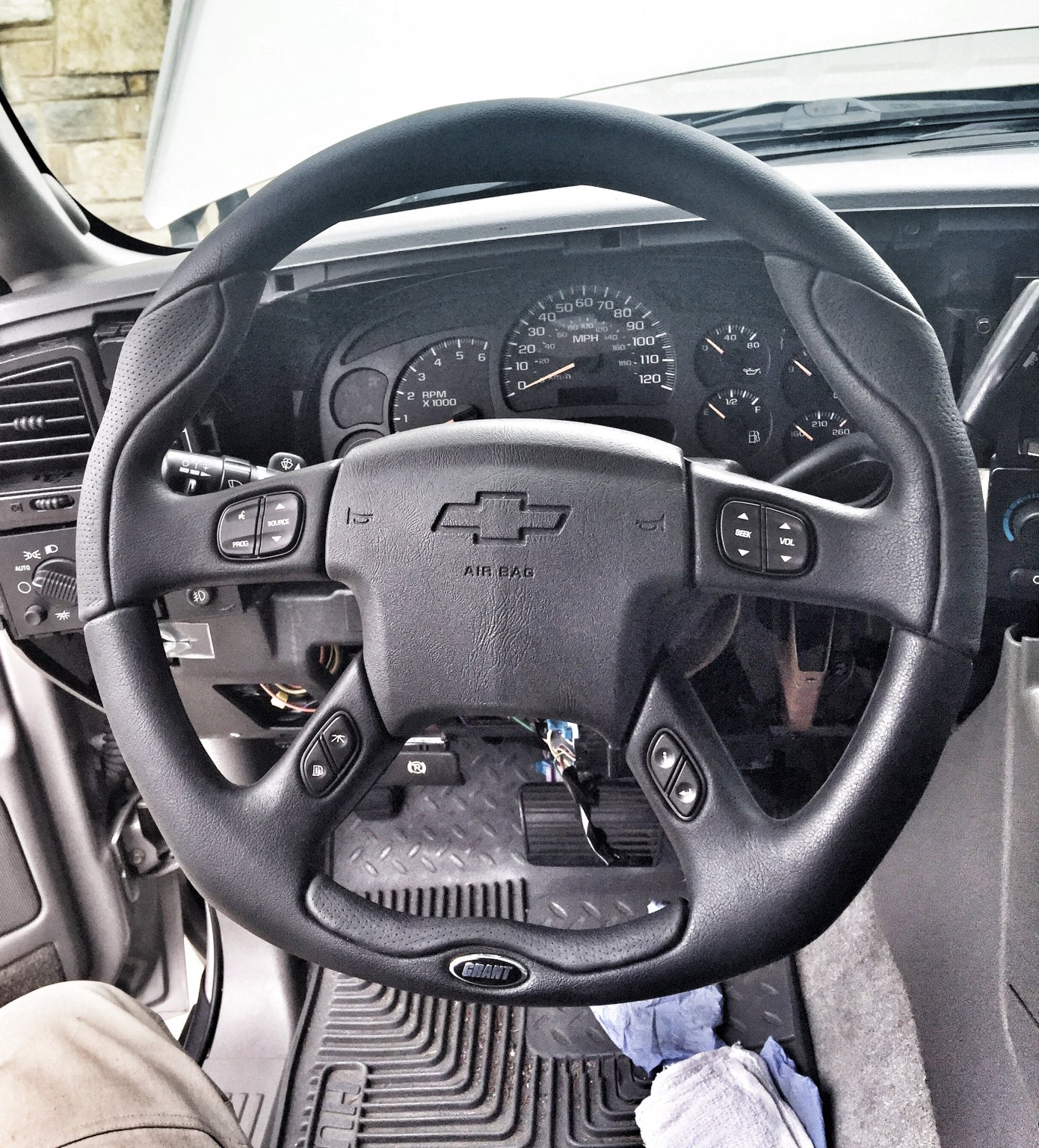

Here's a Grant Revolution airbag steering wheel replacement in a 2004 Tahoe Z71. Install was relatively easy with the YouTube video that Grant has online. Pulling the wheel was made a little more complicated than it needed to be. Also replaced the steering wheel control buttons since the old ones were beaten up and three out of four had burned out lights. Very happy with the new product and new look.IMG_7609.JPG

Here's a Grant Revolution airbag steering wheel replacement in a 2004 Tahoe Z71. Install was relatively easy with the YouTube video that Grant has online. Pulling the wheel was made a little more complicated than it needed to be. Also replaced the steering wheel control buttons since the old ones were beaten up and three out of four had burned out lights. Very happy with the new product and new look.View attachment 58149
How do you like that steering wheel. Looks different but nice. Does it feel of sound quality?
