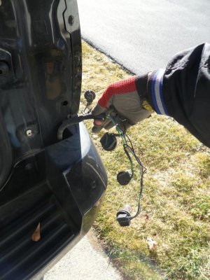

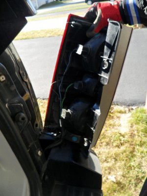

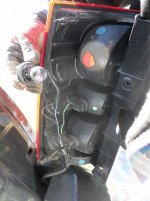

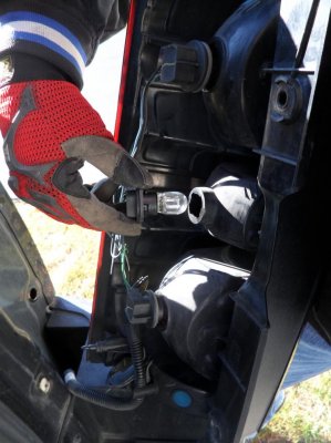

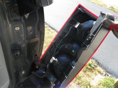

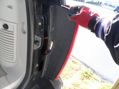

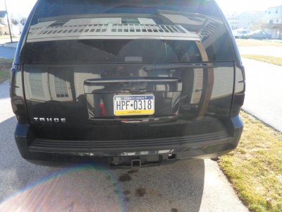

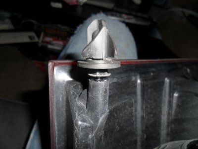

So I just installed some tail lights I just received (Thanks 07Z71hoe!) and thought I would share on how I did it. Bare with me on the process as Im not too good at writing how-to's. Hope this helps anyone who needs it!
1: Put your car in park and ignition off (obvious I know)
2: Lift your tailgate
3: Look at your tail lights and there will be two screws on the inside. Unscrew them
4: Gently pull your lights off
5: Turn your bulbs and gently pull them out. Be careful not to touch the bulb itself. There will be a few wires that you will need to pull as well. They are wedged in between a piece of plastic.
6: It will be just the wires and bulbs.
