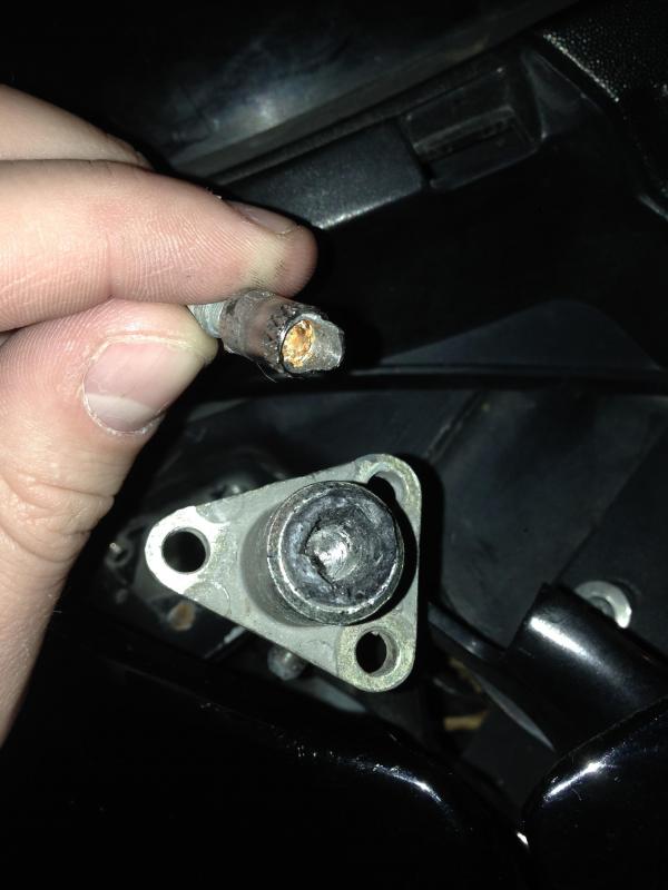

Well this happened when I accidentally went through a car wash with the stupid antenna on. Any ideas on how to fix this error?
Grimes
Apr 13, 2013
413
It seems you have deleted your antenna!
Any signal at this point? Do they fit at all, or were chunks lost? Could also consider soldering some copper between them, maybe?
