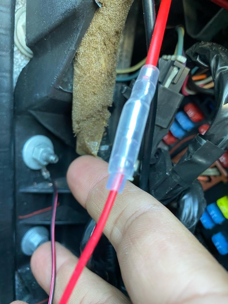

This thing is kicking my butt. Ground is to a bolt to frame and power is on the fuse tap to a fuse. The camera is still not getting power. Tested the fuse with a multimeter, 12v with acc key position. Not sure what I’m missing. Any ideas? Thanks all.

Do you have a picture of how you’re tapping into the fuse block or at least a hint as to which fuse you are tapping into?
