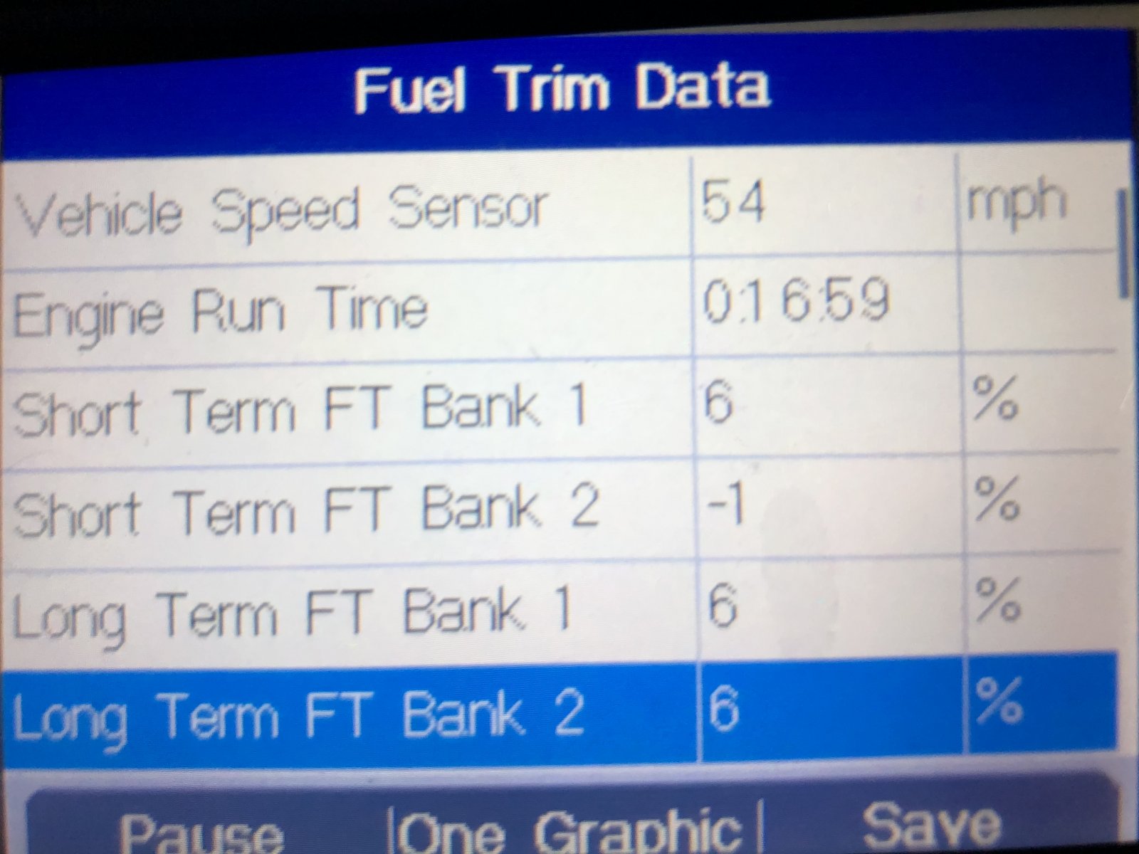

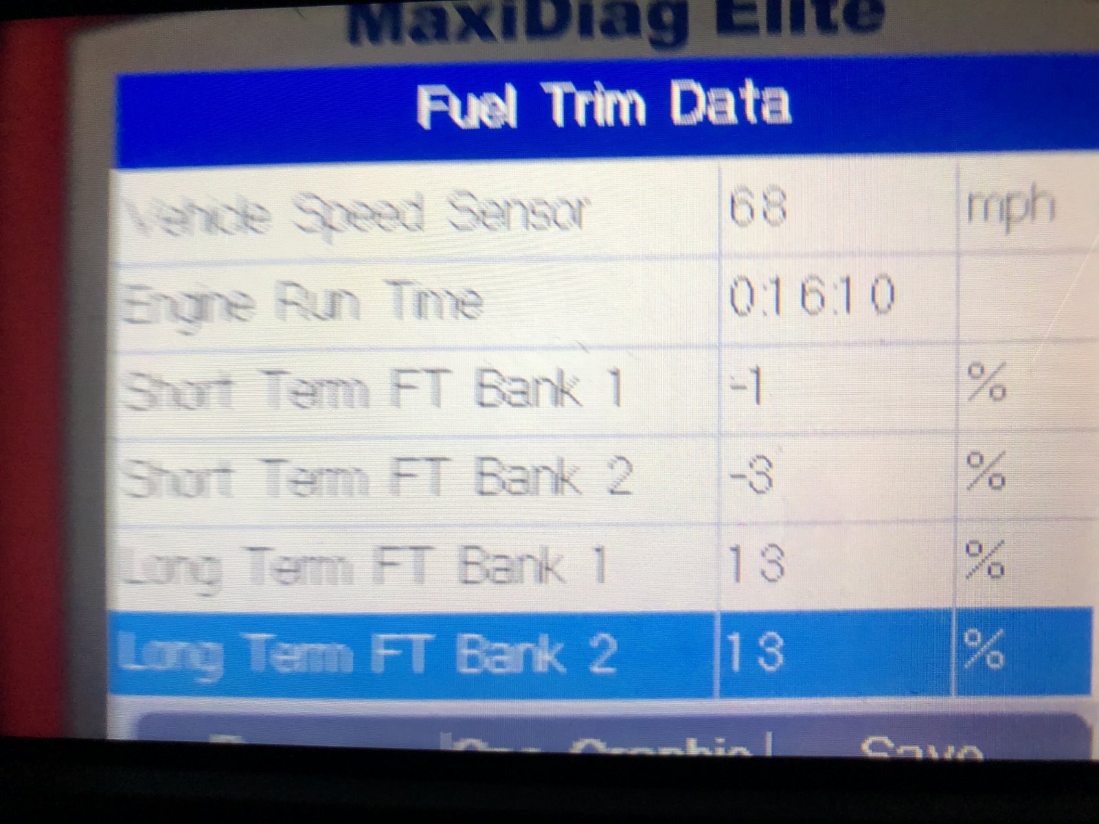

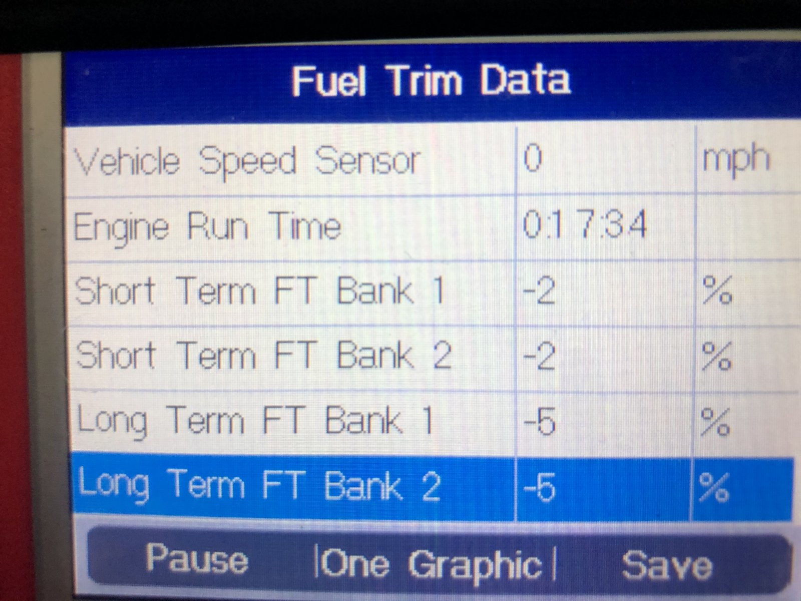

OK heres some pics. If you look at the vehicle speed on the screen, one is at idle with the - numbers, one is normal cruising at about 55mph/1500 rpms, and one is accelerating from 55mph not wot but maybe 50% pedal. They are average representations from multiple drives which only varied one or two numbers, but most of the time driving normally the long term trims both banks are trying to stay right about +6

Scottydoggs
Dec 16, 2017
2,881
4,516
NJ
13's are a bit lean. maybe have that afr setting put back to the way it was. see if it makes a difference.
