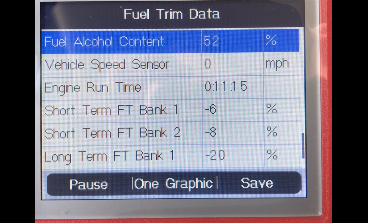

This was from the other day. The fuel comp learn mode doesnt always activate after refueling, and I mean 10 or more gallons each time, then randomly it will activate the next time and go from 20% to 50% to 27% then stop on something like 50%-70% within like 2 minutes. I'll check other things like 02 sensors, but bottom line I want to delete/disable anything related to flex fuel operation on this thing, Im tired of it

-20 is rich af. content sensor might have gone bad too.

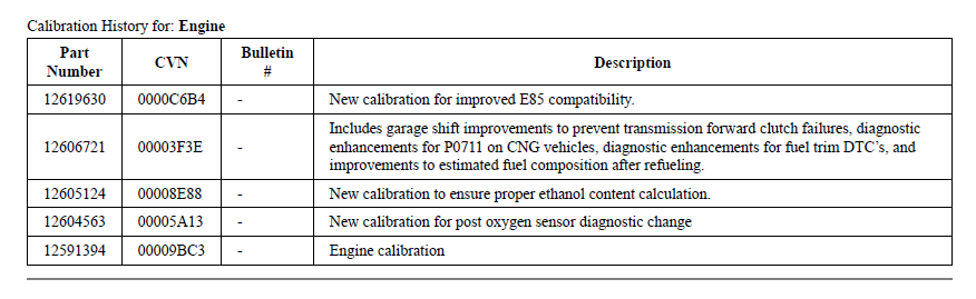

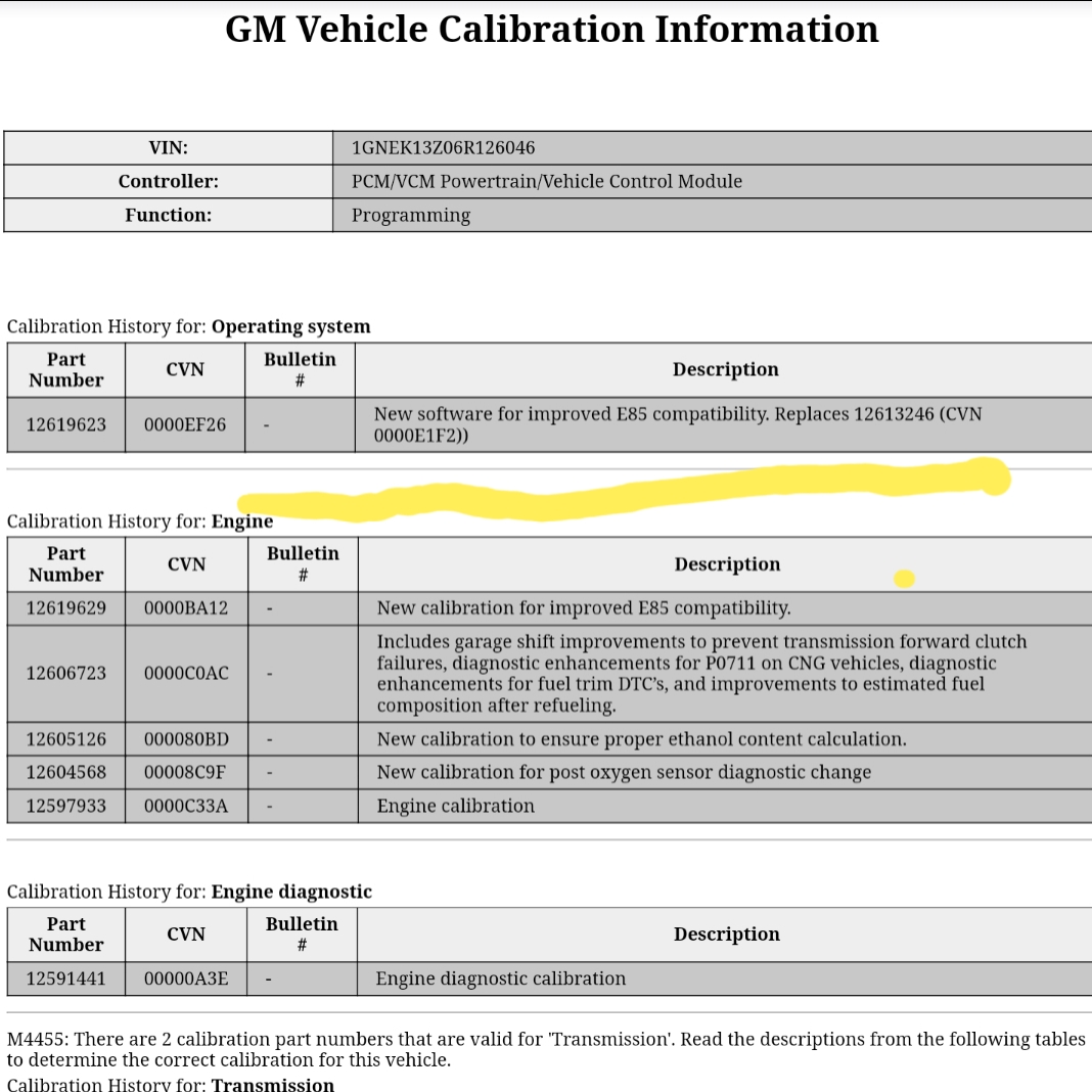

While that's a good example, below is what the calibration history looks like for the OP's VIN. Slightly newer calibration for the engine. As well, there are other non-engine calibrations that can affect the fuel composition calculation.
Odd that they are both 06s and there are 2 different os updates...

Thanks a lot for the info. So is that calibration # something I could take to a dealer and the should know what Im talking about upgrading? I checked the Tech II owner list post but didnt see anyone near me in NC with one. Will also look into the cost of one of the custom tunes and whats involved with loading that on my ride. I got some gas today and now Im showing 63% alcohol lol
Moderator
16,282
33,657
People's Republic of Colorado
Yes. Updating the calibrations shouldn't take much time. I'd think less than an hour's worth of shop time. They do it all the time. But discuss your concerns before you have them update.
