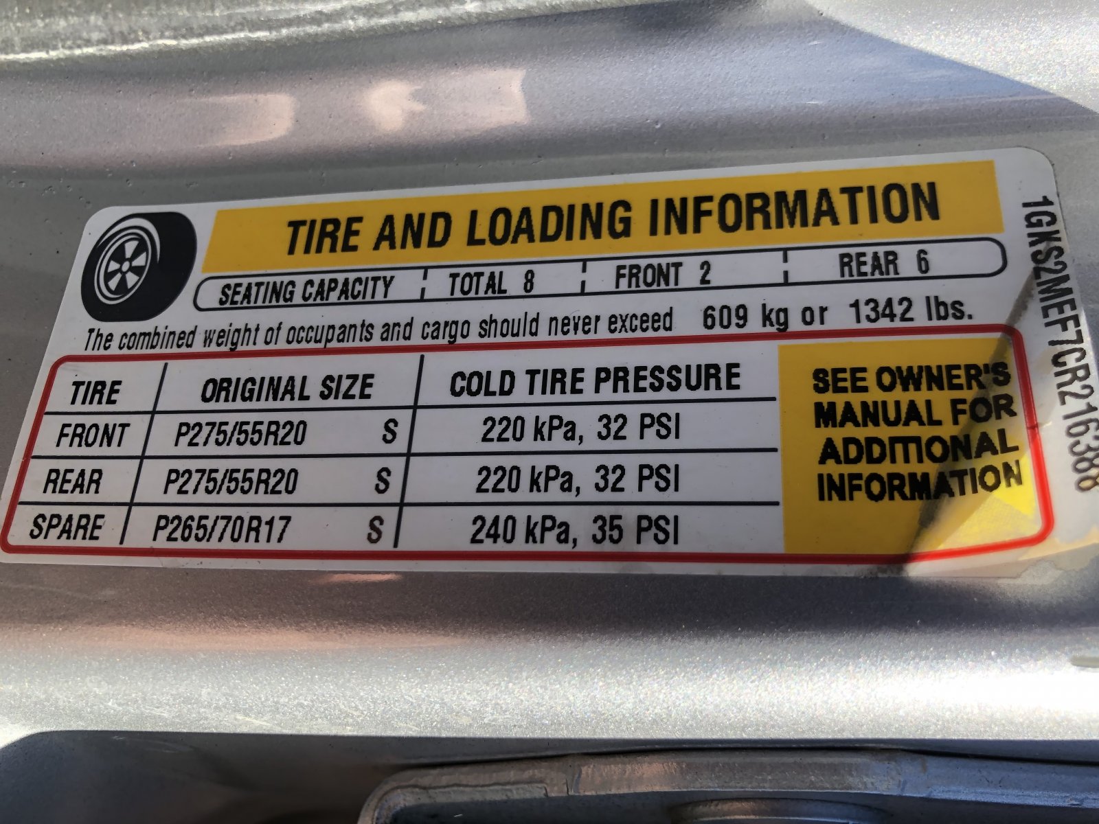

Here’s how ours stacks up on the CAT scales loaded with my wife, 2 kids and gas for camping. I’ve also included our payload sticker to show that we’re within the limits of both axles and the payload capacity of the truck, but only just. We use a Camco Recurve R3 hitch with integrated friction sway control, and have no problems with sway. Note that the tongue weight on the camper comes in at about 700 lbs, so total weight of the camper with propane and all of our gear is actually closer to 7200-7300 pounds. I’ve also pulled it with a generator on the rear bumper of the camper and a full water tank, which together add about 600 more pounds, and couldn’t tell the difference.

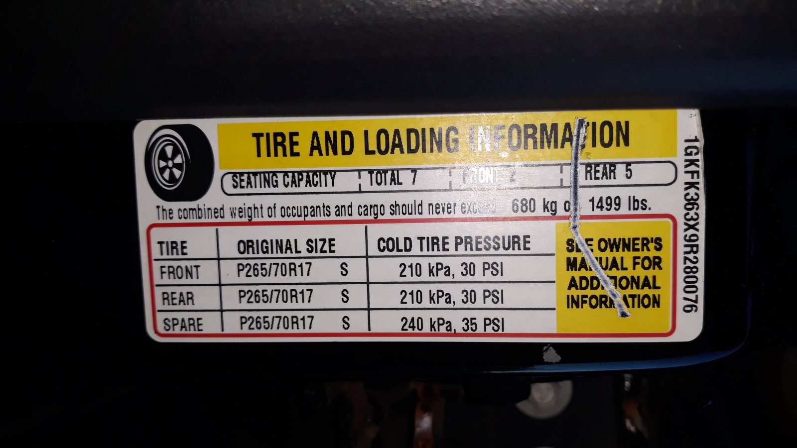

Your girl weighs 100 pounds more than mine! Is that what those Dubs and air suspension add? My payload capacity is 1499 pounds with the same GVW Rating, so her original curb weight was 5901. Right after I put the new Michelins on, the CAT Scales say she weighed 5860.

Geez...1342 lbs payload? o_O
My family of five, now three adult children including my fat butt, weighs 900 lbs. Wouldn't have much payload left for a trailer.
That's why literally everything we take camping with us goes into the trailer and not into the back of the Yukon. The ONLY things in the Yukon, besides seats and a steering wheel, are 2 adults, 2 small-ish kids (10 and 13), and a 65 lb. dog (all in about 650 lbs. of meat :cool: ). We even take the third row out on most camping trips. But again, that 6.2L pulls it all with ease and the truck and camper combo are very stable.
