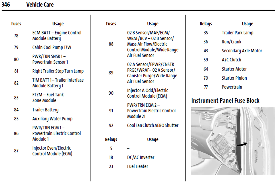

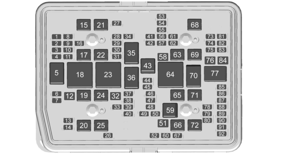

probably 10 different fuse that could be pulled in the fuse box that would cause it to turn over and not start, no need to make it harder than it needs to be.

Or you can unplug the fuel injectors.
There's a thought. Maybe # 87 & 90 feeding the Injector ECMs.

Either disable the injectors, or maybe get a relay tester that allows you to jump the relay manually and crank it...

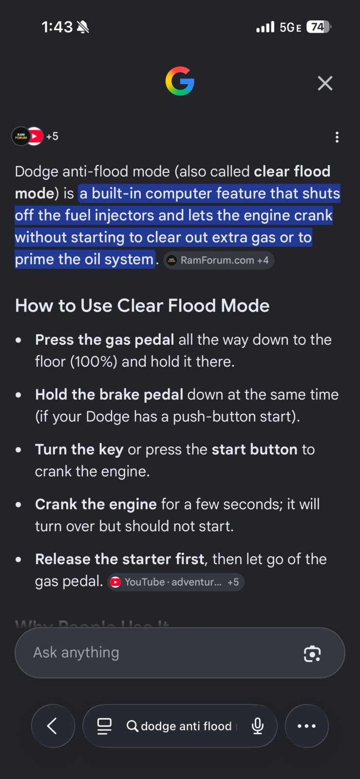

Disabling the fuel like I said is the best way. It’s actually a feature on my Dodge hellcat just for this scenario. If you floor the gas before you crank on my Dodge it will disable the injectors so you can prime the engine.

Is there a way to crank the engine with no start to get the oil circulated a bit after sitting?
On every petrol engine since the ecm/pcm became a thing, smashing the pedal to the floor enabled 'Clear Flood' mode:
injectors temporarily stay closed so long as TPS%=100. Later learned that if the TPS is relaxed under 84%, injectors reopen.
Been doing it after every single oil change since the 90s.
I also do it for 1 full second for every wintry cold start, then totally lift while continuing to crank. Do turbodiesel engines have a 'Clear Flood' mode?
Just tried this: One foot on the brake, accelerator to the floor, then press the start button. Engine starts then idles as it would with foot off the accelerator pedal.
What you describe is an interesting feature on new EFI gas motors.
Which is another way of saying, this turbodiesel LACKS 'Clear Flood' mode.
