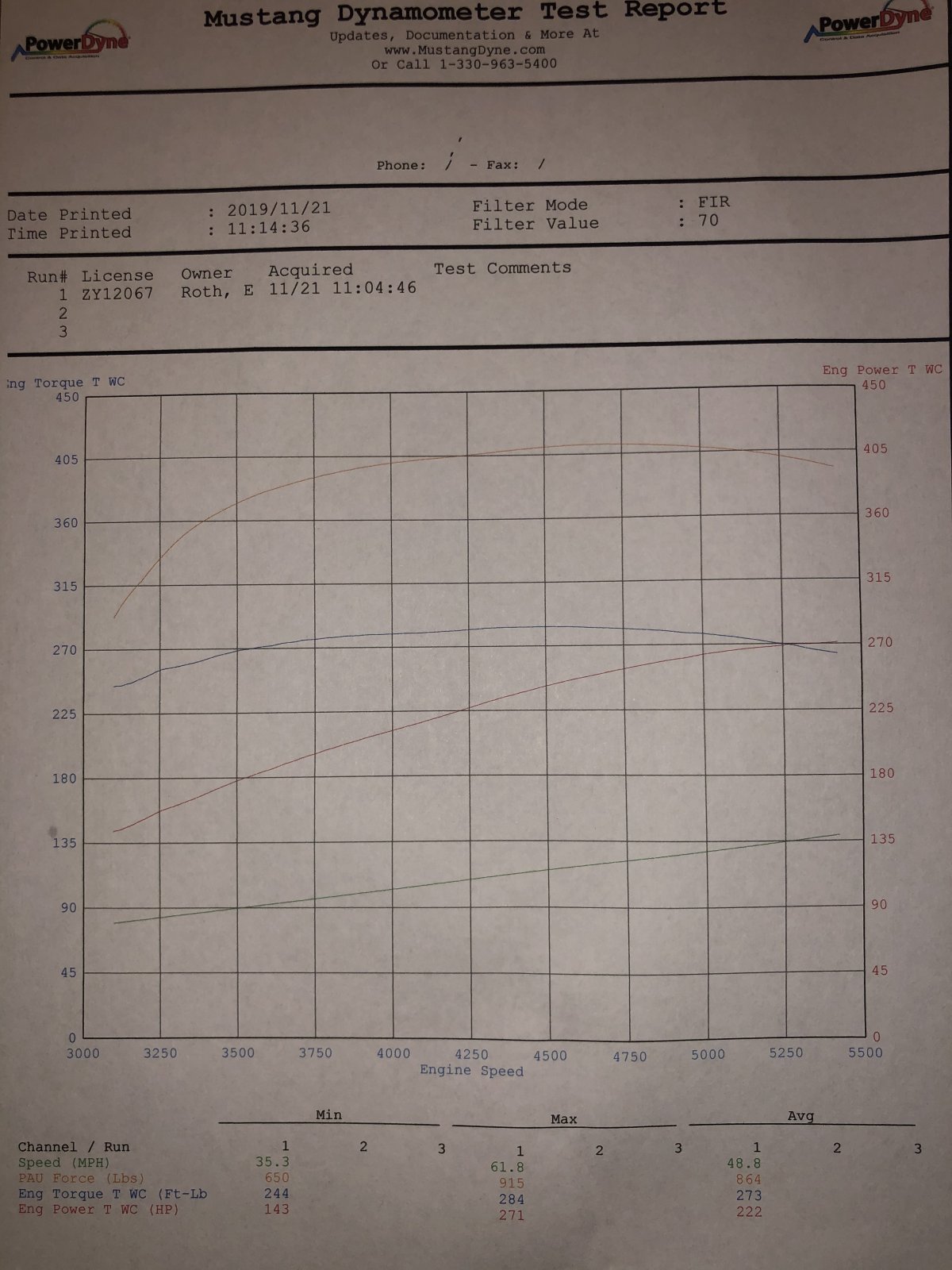

Hey guys and gals ! I have an 09 tahoe with a stage 2 tsp custom truck cam and have gotten a custom dyno tune . I have ls7 lifters , ls6 springs , DOD delete , ls2 timing sprocket and guides . Hardened push rods and the cam is a high lift 212/218,.600/.600 ,112 LSA, 110ICL . My shift points after getting the tune are 5500 rpm . I don’t have intake or exhaust . Would I get much more power after 5500 and would it be safe ? Thank you guys . I included a picture of my dyno sheet

My stock motor shifts at around 5800 rpms with its BlackBear tune. So yes, a cam like that needs to rev to reveal its power but not much more over 6000 since a stock 6L80 is limited to 6200 RPMs.
Do you have before and after pulls? Any track time? What gears? My eyes aren't good enough to read the sheet, what does it say?

It was a mustang dyno , 4th gear pull , 271 hp , 284tq . He said it would get another 30-40 hp on a standard dyno . Everything on the truck is stock besides the listed upgrades

like stated, the cam with have more POWER closer to 6-6.5K rpm...but the intake with restrict it. The TORQUE will be greater as is, probably upto about 4.5K rpm.

Looks like torque peaks about 4,500 but hp is climbing until the end. Would you get more power with an intake and exhaust? Yes. Where? That's to be determined. You need to decide where you want it.
Primary diameter and Primary length.
Large diameter = higher rpm peak torque
Smaller diameter = lower rpm peak torque
Longer length = more area under the graph before peak
Shorter length = trade your low end torque to have it not drop off as sharply after peak
As far as intake manifolds go, if you want to spend the money then yeah you have options. There are gains out there but they are not much more than the factory truck intake so spend your money wisely. I'm running a FAST lsxhr along with other stuff. But it's almost 14" from the start of the velocity stack to the back of the valve. Being a cathedral head on the 5.3 you won't be able to use that one but you could still run a Holley Hi-Ram or other long runner manifold. As mentioned though, the gains over the stock manifold may not be much since most of the increase will be from the larger plenum volume over the stock intake, not so much the change in runners.
