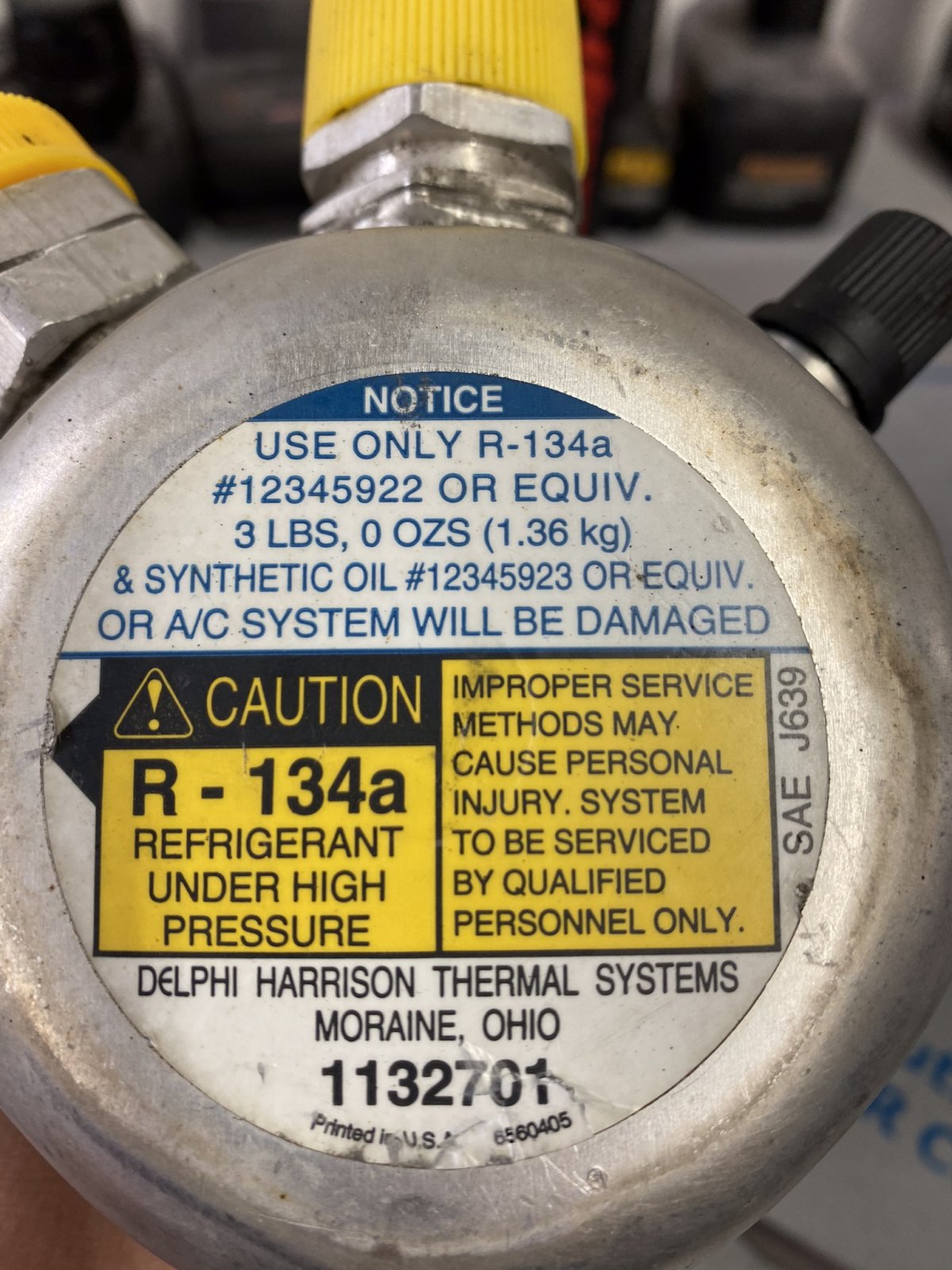

    So I found the decal and if I am reading right ir is 44oz for my Tukon with rear A/C. I will replace the dryer as it has never been changed before. Should I get 3 cans with the dye or just need 1 with dye and 2 without? Also is one brand of refrigerant better then another?
