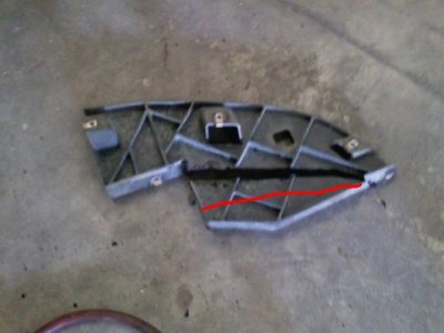

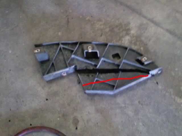

I am thinking about adding some of these to my Nitto Trail Grappler MTs (285/65/18) to my 07 Z71 Tahoe. Do you guys think that the best way to not get any rubbing is to go with the CCM 2.5" front/1" rear leveling? Thank you guys for everything,
Peyton
That is exactly what I have and you will still rub the wheel liner and the bottom front valence cap (full lock and gets worse when fully flexed). It appears the non-Z71s do not rub. Yes this does not make sense for an offroad package...
The red line is what I needed to trim off that piece. Not a big deal.
