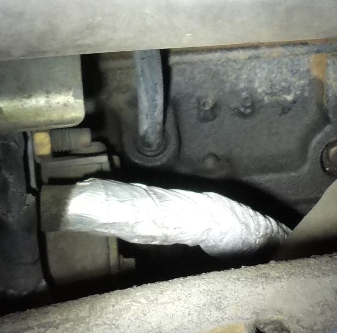

FWIW, here's a pic of my '04 5.3L 4WD, shot through the wheel well. I can't get a better angle underneath.
It almost looks like the dipstick tube is dimpled, or maybe that's part of the oil pan. I don't see any tapering to the tube outside of the oil pan.
Thanks for your time and for the pic, but I'm questioning the transmission dipstick tube. Although, your pic does answer something else I was questioning: I wasn't sure how that shield over the starter solenoid went cuz it popped off before I had a good look at it.

Here's what mine looks like, but it seems to have that "stop" in the tube. I know, it needs a good cleaning.
Thanks for the pics! Yeah, it's very different than what I'm looking at. I decided since I couldn't move it side-to-side that it must be all the way in and tight. Maybe they changed the design to make installation more fool- and leak-proof?
