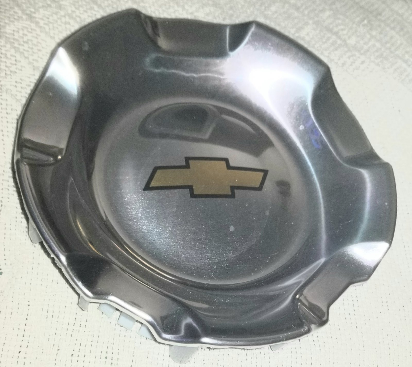

I have a 2007 Tahoe LTZ with the 20" Polished Aluminum 5 Spoke wheels.
Is there any way to make the center caps theft resistant?

Is it possible they are just falling off? The spring retainer on two of my caps were loose and I had to add duct tape to make them fit tightly again.

My hub covers occasionally disappear, especially the fronts, and its mostly from road conditions. I put 3 dime sized blobs of polyurethane glue on the back of the cover so it bonds to the wheel and it keeps them on between tire changes. Its easy to bust them loose when you need to remove them, the poly just peels off
