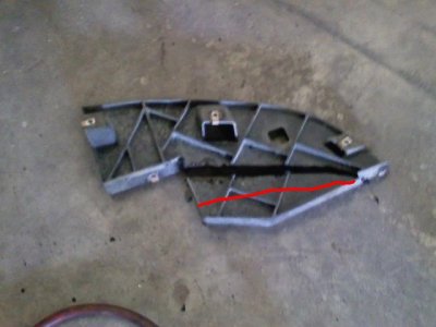

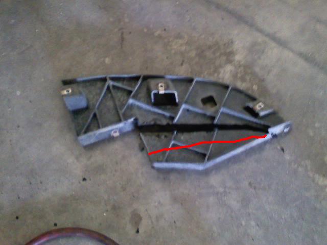

Can anyone point me in the right direction to find an actual pic of the trimming done for a ccm leveling kit a and 33's?

The attached shows trimming I did (the red lines) to fit 33s with CCM kit. This was about 2 inches. I think the original pic was from someone trying to fit larger width tires (305s?), but at that size they also needed to remove the side steps.

James every car is gonna be slightly different. Just turn your wheel and see where it hits the wheel well. When it hits. Stop and get out of the car and look exactly where it's hitting. Go back in the car and turn the wheel back straight and cut around that area. That's all I did and I'm fine now. I'm running a leveling kit and 33's...
