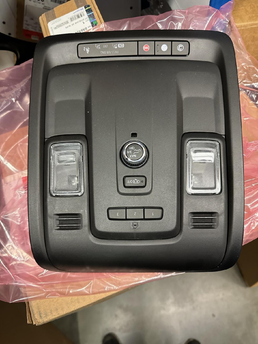

Wanted to share some information that I spent quite a bit of time trying to find.
Have a 2021 Yukon SLE with OnStar and that's really about it, no power lift gate, no sunroof.
I was able to add Homelink by purchasing GM 86575298 overhead console. See picture below.
This console has OnStar, Homelink and power lift gate. I was not able to find one with OnStar and Homelink only.
I replaced my original overhead console 85164204 with the new one described above and the original wiring harness provided power to the 3 Homelink buttons. No modifications necessary.
Programed garage doors all working great.
Programed garage doors all working great.View attachment 418854
please how much the price of this console ??? is your case can be done with Yukon 23??
