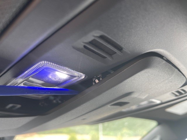

Plastic pry-tool at the front edge as shown - there's two notches on either side. One is right in line with the OnStar button I use the one on the opposite side because I don't want to accidently call On-Star... Stick the tool in the notch and turn it 90deg until you hear the push-clip release. You can then slide your tool toward the other side and get the other tab to release.
Forward push-clips released:

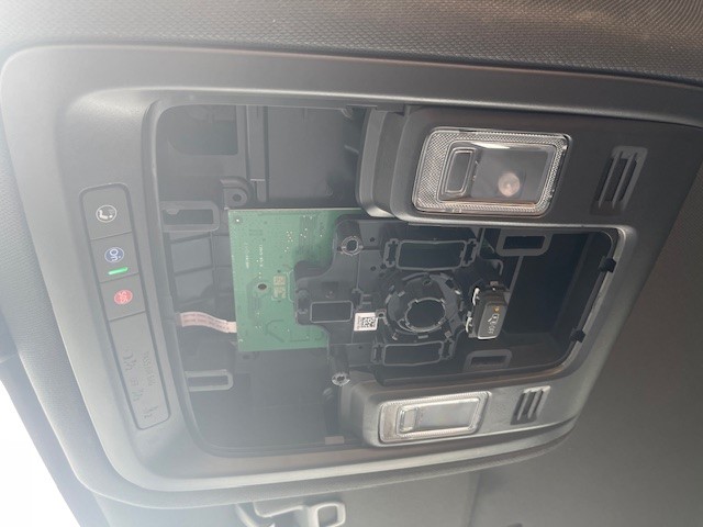

Two more push-clips are on the trim panel just aft of the dome lights. Pry with your trim tool as shown and drop down the panel.
Backside of the trim panel for reference:
Remove the T15 torx screws in the pockets towards the front of the OHC.

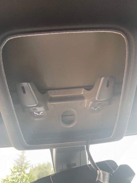

This is where it gets a little bit tricky. After those screws are removed the only thing holding it up is two more push-clips about in-line with the dome lights (see picture below). Those clips grab hard so you'll have to pull down with some extra effort. It helps to pull down the front of the OHC, then work your fingers around to the side and pull down next to one of the dome lights. Repeat for the opposite side.
OHC is removed and this is the empty space you're left with in the headliner.
