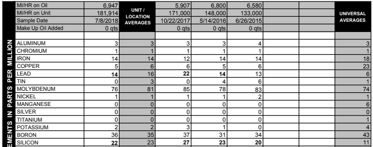

Hi everyone,
I've sent four oil samples to Blackstone Labs over the last 3 years, and each time my silicon readings have been higher than universal averages (see bottom row of the attached picture). The techs at BL have suggested checking the air intake system for cracks or leaks, implying that dirt and debris may be getting into the system downstream of my air filter. I've looked, but haven't found anywhere that appears to be leaking.
Have any of you had similar issues you resolved, or do you know of any common failures points on the air intake system I can target?

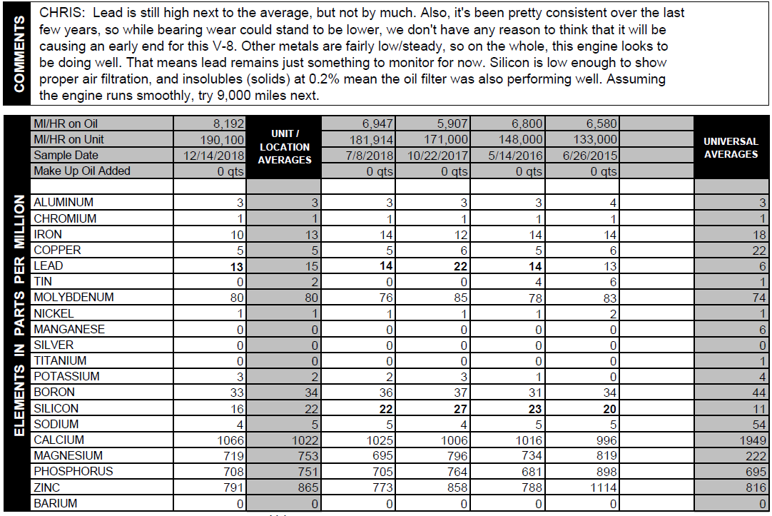

I received my oil analysis today. My two concerns were lead and silicon.
Lead:
After replacing a faulty oil pan pickup tube o-ring in December 2017, my lead has dropped considerably from 22, to 14, to 13. It appears this is just normal for my motor given the history going back to June 2015 around 133,000 miles. So, it appears things are doing well on this front, even if my vehicle averages are about twice the universal average. I'd love to hear anyone chime in who has had oil analysis done on their rig to see if they are seeing the same, or something different.
Silicon:
As for silicon, it dropped from 22 to 16, so I'm going to call the new air filter and additional/larger screw in the housing a win. It is actually the lowest it's been in the last 3.5 years/60,000 miles, so that is encouraging (again, despite being higher than the universal averages column).
Other than that I'd say the old girl is doing well for approaching 200k!
