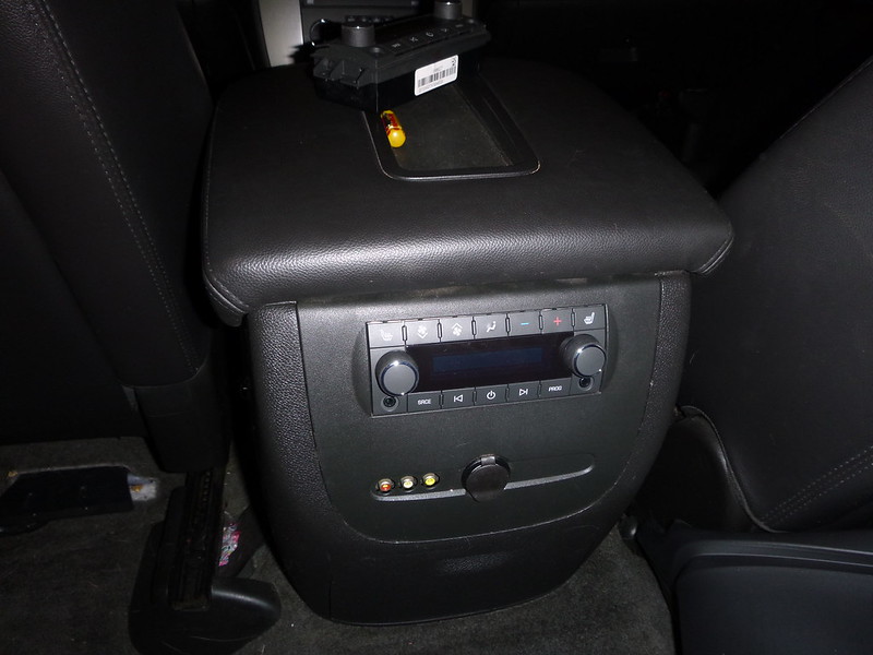

2009 Yukon SLT2 sometimes would have a high pitched sound from the rear speakers.
Would also sometimes make a gong sound when turning off the ignition.
Here's what solved my situation thanks to TahoeYukon form.
A number of threads pointed to the rear climate control. Figured I'd give it a shot since everything else failed that I've tried.

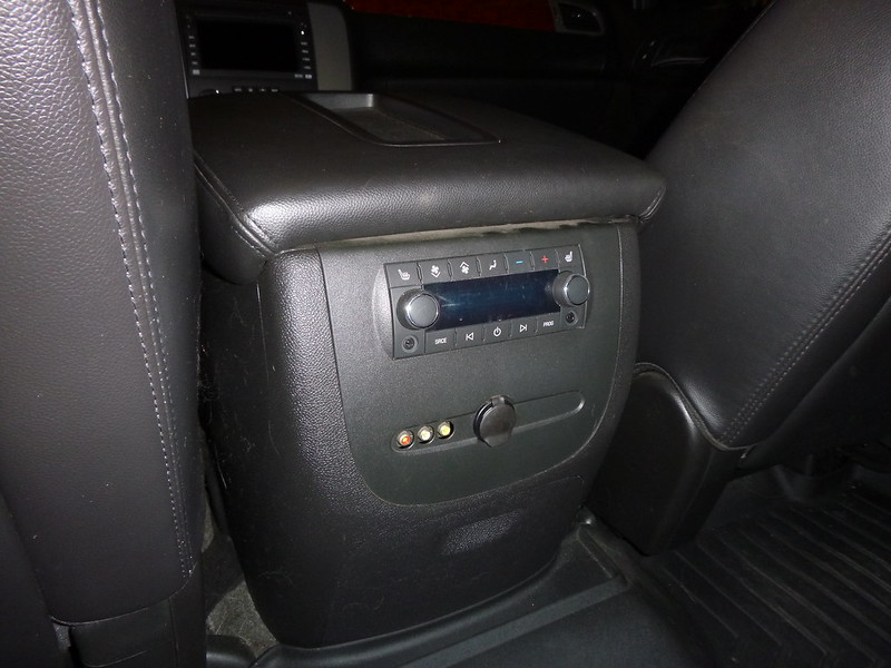

Here's my culprit.

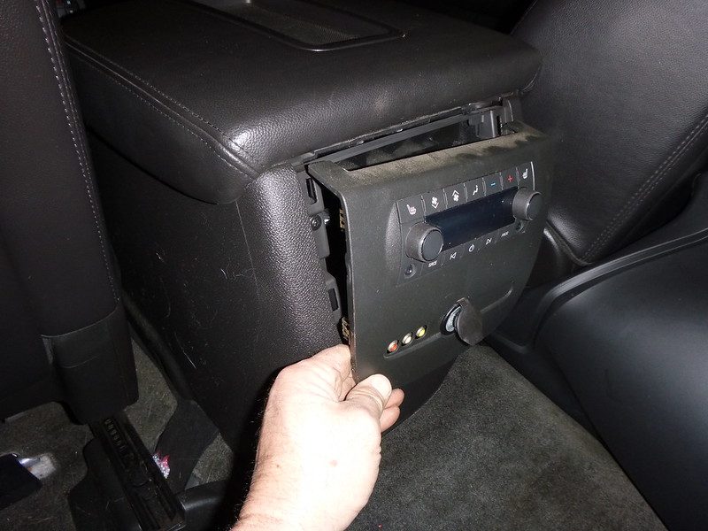

Removal is fairly easy, thanks again to this forum.
To get the connectors out, one needs to dis-engage these locking tabs.
So this tab can be squeezed to remove connector.
Then you can see what fasteners need to be removed.
