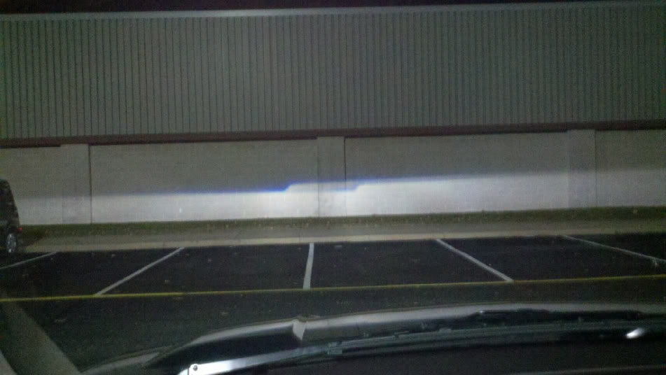

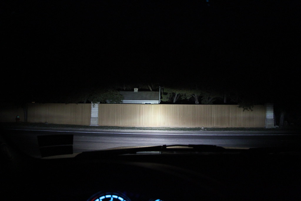

Here is Low beam

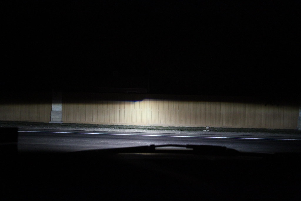

High Beam

something don't look right, one of them is off rotation and needs to adjusted laterally outward. neither of those adjustments can be done w/o opening the headlights.
should look more like this

Maybe not perfect but pretty damn good. Beats the hell out of the cheap ass HIDs in my Tahoe and OEM headlamp assembly. I like it.
Well great! lol could this be that I need to adjust the headlights down?

Mmm ... I wonder if that's on purpose.
I've seen a few folks prefer sloped cutoffs, although not usually with MH1s.
You might be able to adjust it a little by loosening/tightening the screws of the headlight housings, especially the ones on the sides.

Matt got your email and just read through this post. If you can email me over individual pictures of the LH & RH projectors output.
The projectors we use have a small amount of rotation built in, for this exact scenario -- so if you have a small bit of time to tweak them I can walk you through the process.

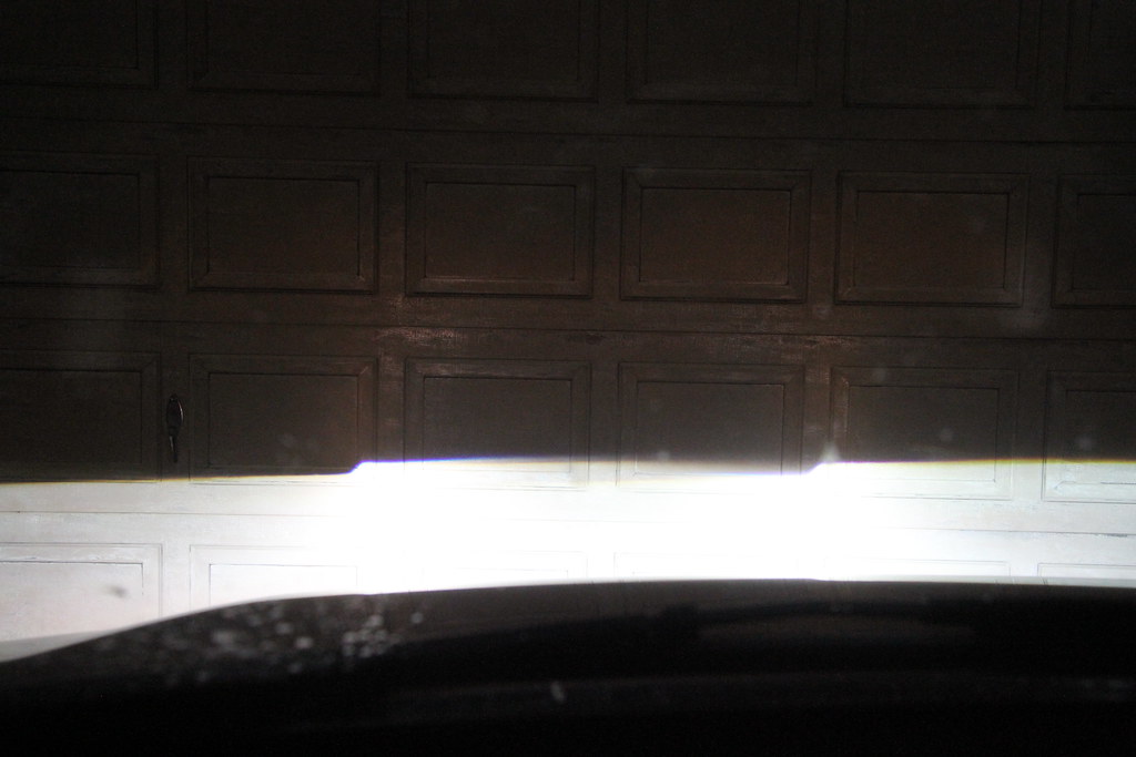

Hey is this a better Picture ?
I thought my camera was good, but cant seem to capture the cut off
Looks better -- but it also looks like you're really close to the wall. Ideally you want to be around 30 feet away on a level surface with a flat wall.
