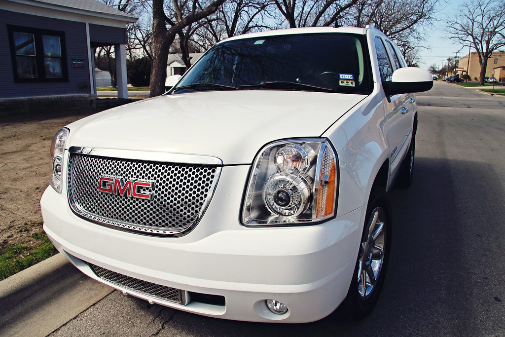

Wow your Kit is gonna blow mine out of the water, no surprise there. haha
metal4all6, Here is a pic of them installed. Ill create a thread once i get the suv washed.
