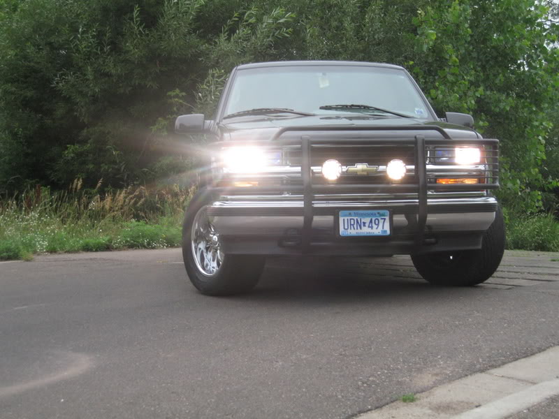

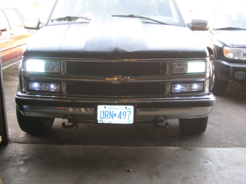

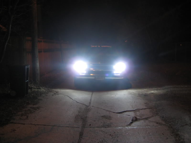

i have had te ebay bulbs, some ebay hid's and 2 sets of DDM hid's and my favorite so far are the ddm's the quality is amazing.
ebay bulbs
ebay hid's
i have a pic from my old 35 watt 10,000 K (DDM)
and my new 55 watt 10,000 K (DDM)
(35 watt)
(55 watt)
i hope this helps you make the right choice (poke poke, nudge nudge, DDM!!!!)
