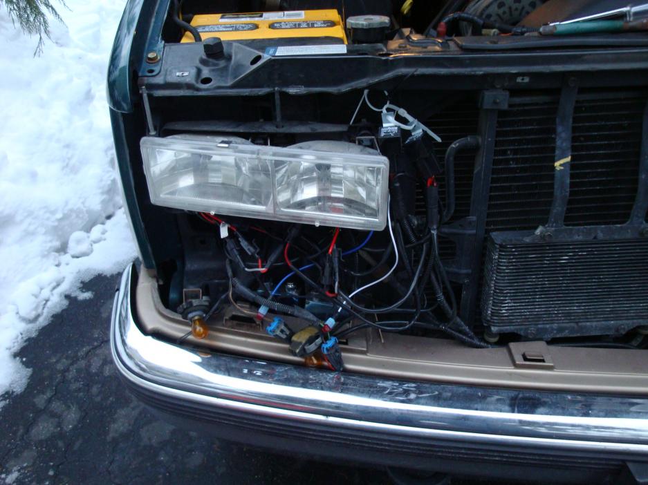

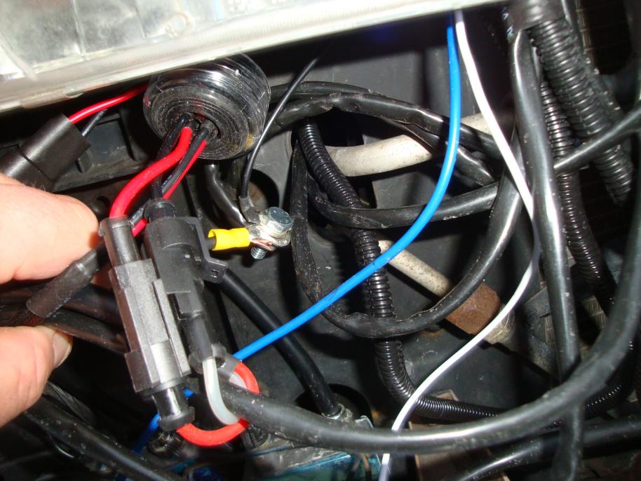

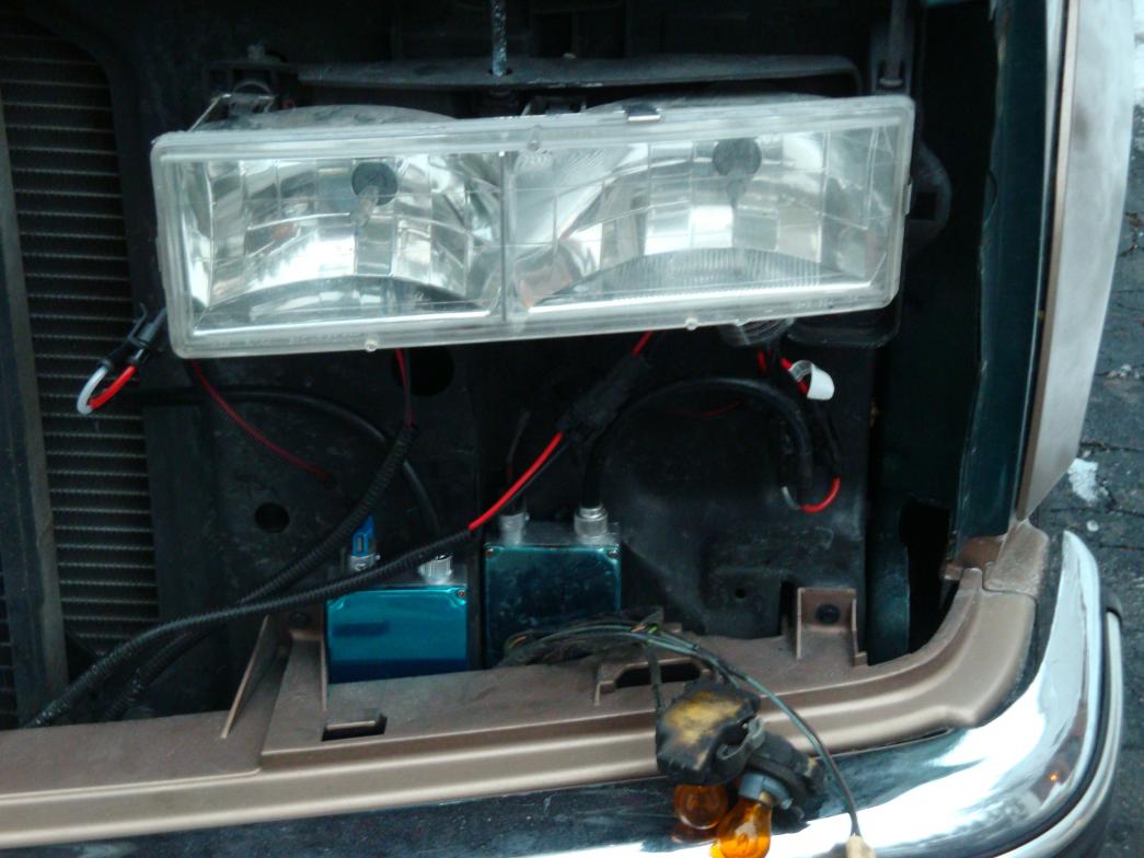

Here is my set up
laxman21
Nov 5, 2010
39
Yes you can as the 4 high kit splices(really clips in) into your factory wiring harness on the passenger side before you plug it into the HIDs
Here is my set up
Ground wires all together with the bolt
Ran a 10G wire to the ground by the battery
Positive hook ups. HIDs to battery and 4 high to distribution block
