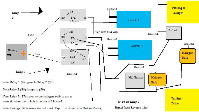

I did this finally on my truck and have two toggle switches hooked up to it. One switch to alternate between the hid bulb and halogen bulb so when I'm reversing. The other switch is for the tailgater switch, which will light on the hid bulb.

I have a diagram for how I wired mine I'll share in a bit

Heres how I did mine (diagram)

Nice diagram. That's pretty easy to follow.
Thanks!!

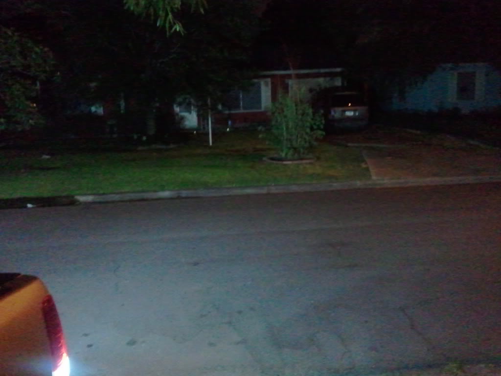

Got any output shots? I don't want a shot looking at the lights, that really doesn't tell me anything. I want to see how lit up stuff behind the truck is with HID's on.
baldd86
Apr 12, 2011
43
I did this to my sierra but it would give you a nice idea of how they will be on your suv.

im curious where you mounted the relays ? also i have sent you a pm. can you please get back to me
also on teh diagram you have power comming from the batter im guessing off one of the auxilary post int eh engime fuse panel ?
